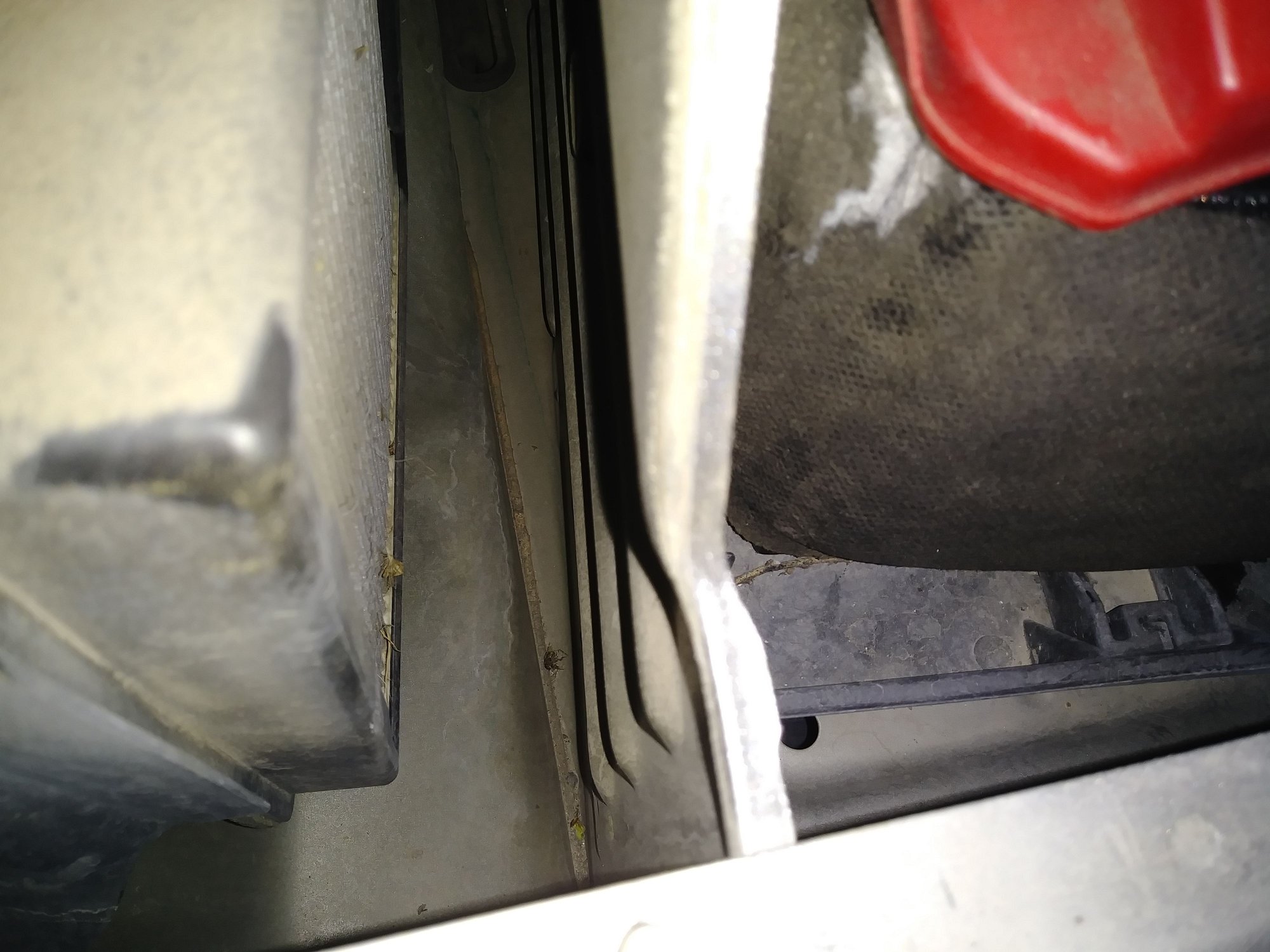

I checked the well by the cabin air filter and it's dry. The drain didn't look plugged either. There was one small leaf in there. I didn't get a picture of the drain, just the area over by the filter. The SJB looks to be in really good shape from what I could see.

I agree, your SJB looks good, so that hopefully is not the cause.
