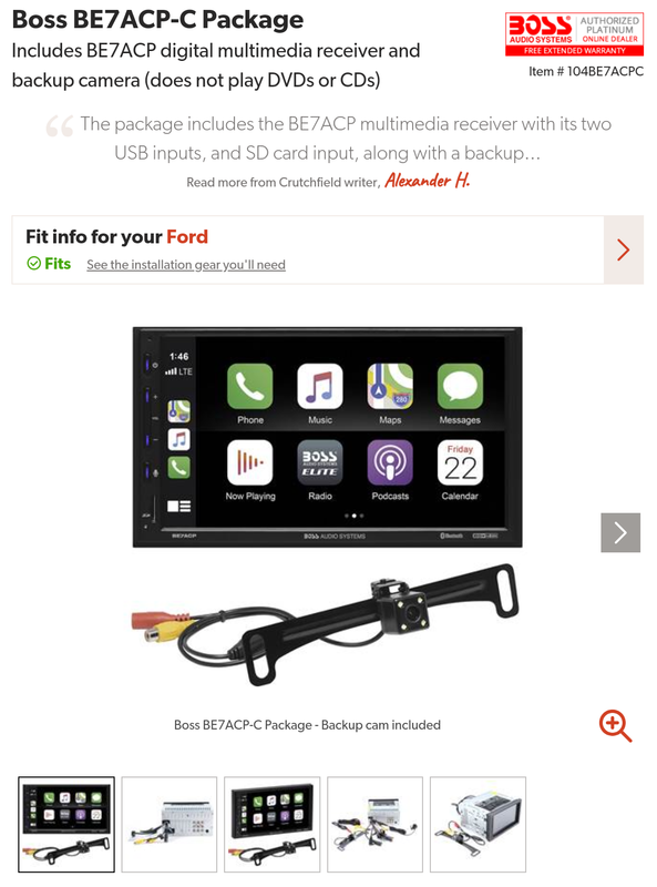

Thx for all the replies, it was radio.
I put in a Boss BE7ACP-C and all is well.
So nice to have Apple Car play and back-up camera.
Hopefully this lasts as long as the factory radio did.

Good deal. Pics? Interested to see where you have the backup camera
Old Feb 27, 2021 | 07:59 PM
Katfish's Avatar
Joined: September 13, 2009
Posts: 140
From: Central FL
It's a simple bracket that bolts to licence plate
