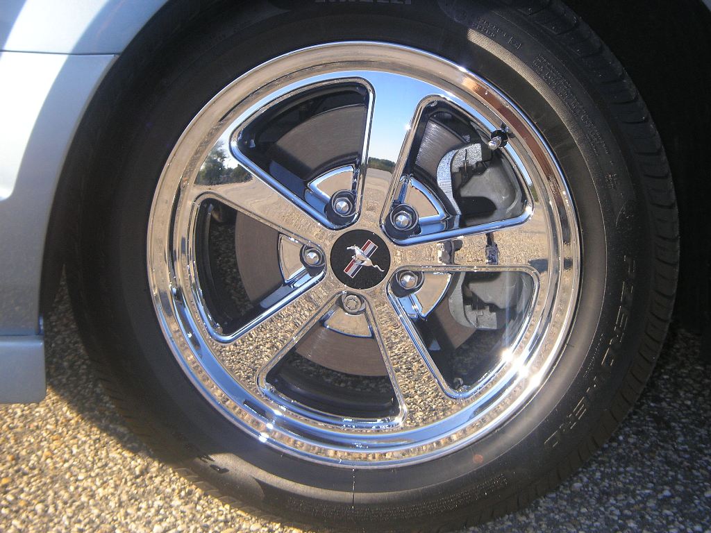

I'm running FRPP Chrome Mach 1 wheels that are for 94-04's on my 05 no problem.
Attachment 20211
http://www.fordracingparts.com/parts...tKeyField=6357
Attached Thumbnails New wheels BUT Frustration beware the cheap deal!-wheel.jpg

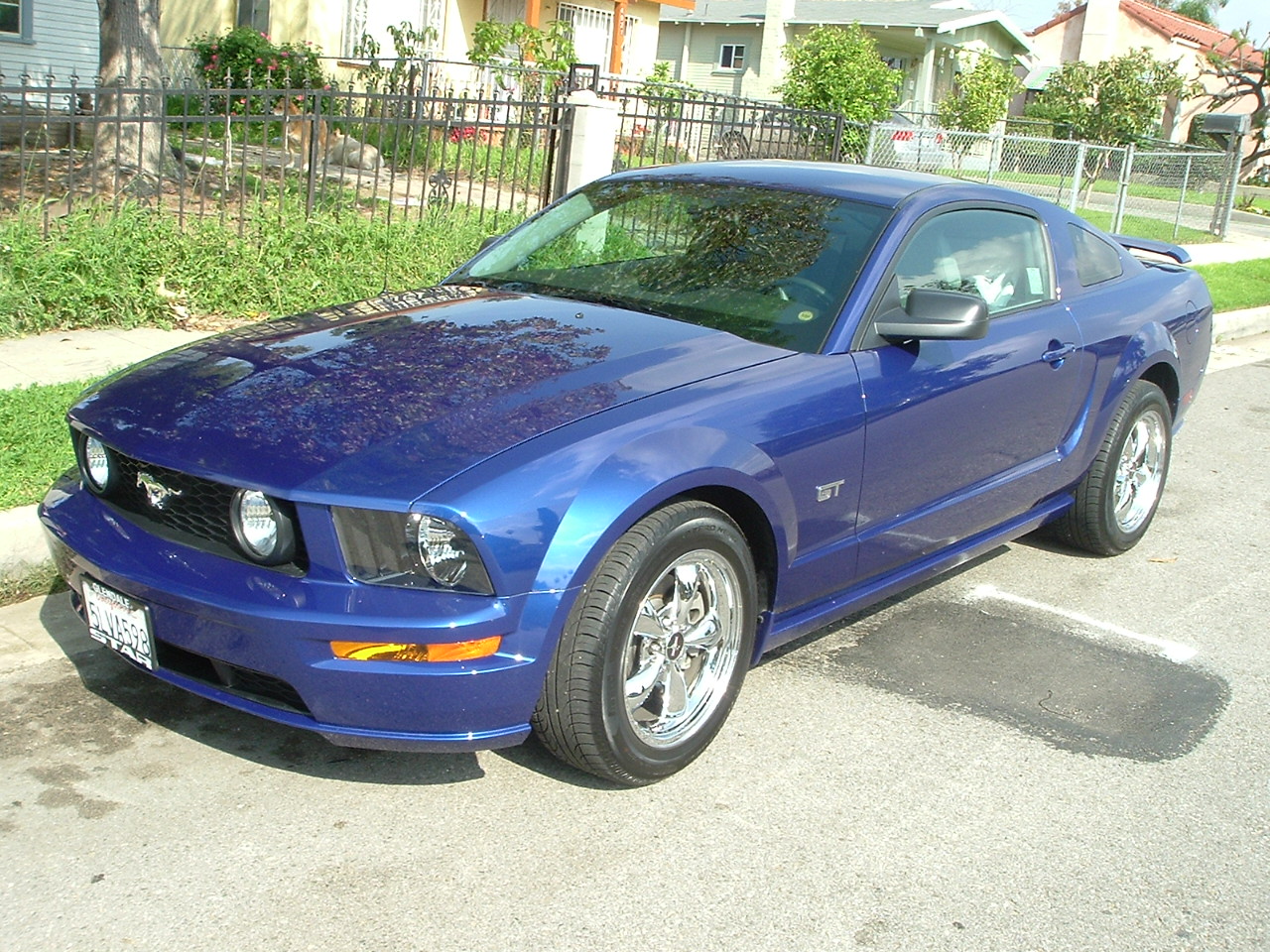

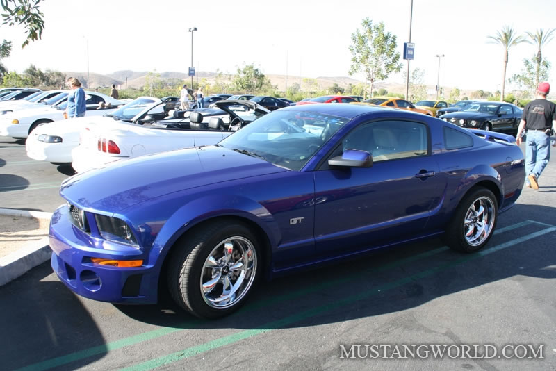

I had been using chrome bullits from the 99-04 MY from a couple days after I got my 2005 Mustang GT until around November 2006 when I upgraded to 18" wheels/tires (18x10 in the rear and 18x9 in the front)...new wheels are chrome deep-dish bullits.
In the close to 2 years I had the 99-04 wheels I never had a problem with them on my 05.
The 1st picture was taken about two months after I got the car. The wheels are from the 99-04 MY
The 2nd picture is what I have now.
Attached Thumbnails New wheels BUT Frustration beware the cheap deal!-05-mustangfeb05-001.jpg   New wheels BUT Frustration beware the cheap deal!-mustangworld_pics_117_jpg.jpg
