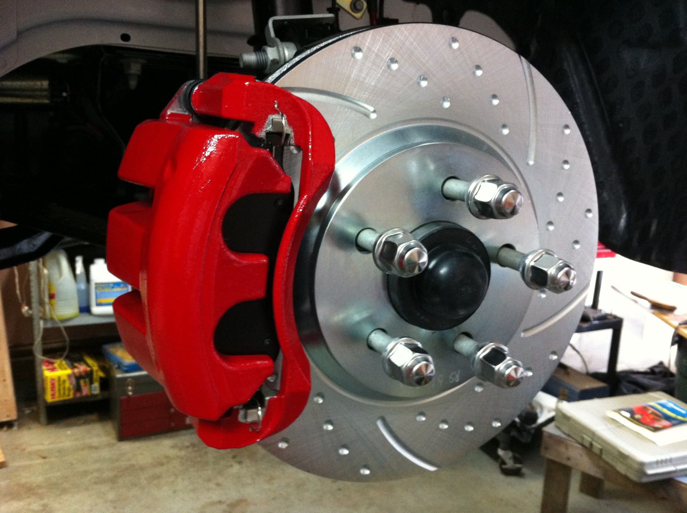

I went with slotted dimpled rotors and SS brake lines from here:
http://www.sdmustangaccessories.com/Brakes_c_39.html
It included free pads.
LJS

Hawk HPS pads for 5 years now, yeah they need proper bedding. Nice brakes btw! Got the Powerslot rotors, SS lines and DOT4 fluid, stops great.
