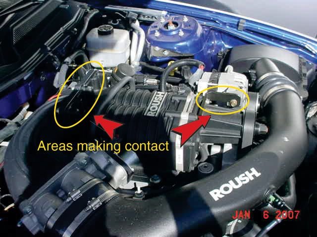

Did a tuner (SCT, Diablo, etc.) come with the car when he bought it? Out of curiosity did he recently fill up with fuel just before the issue happened? If so and he didn't put in 93 octane it will likely cause issues. When I bought my GT in 06' it had a Roushcharger (1.6L) on it and the dealership (A Roush Dealer) told me it needed 93 octane. Also, is the charger the smaller 1.6L version like mine or the larger TVS style? The inlet tube on the 1.6L connects to the left side of the unit with the tube wrapping around the front and connects to the stock air box. If that is the setup and the pulley is larger and solid black it's most likely the stock Roush tune that came with it. If it has a custom tune it would most likely have a smaller pulley on it (possibly a 2.57) and a CAI instead of the stock air box. In that case your friend will need a tuner to see what's programmed in it. Otherwise a Roush Ford dealer as Paris said should be able to check it easily.
Here is what the 1.6L looks like in stock form. Ignore the text on the picture.
