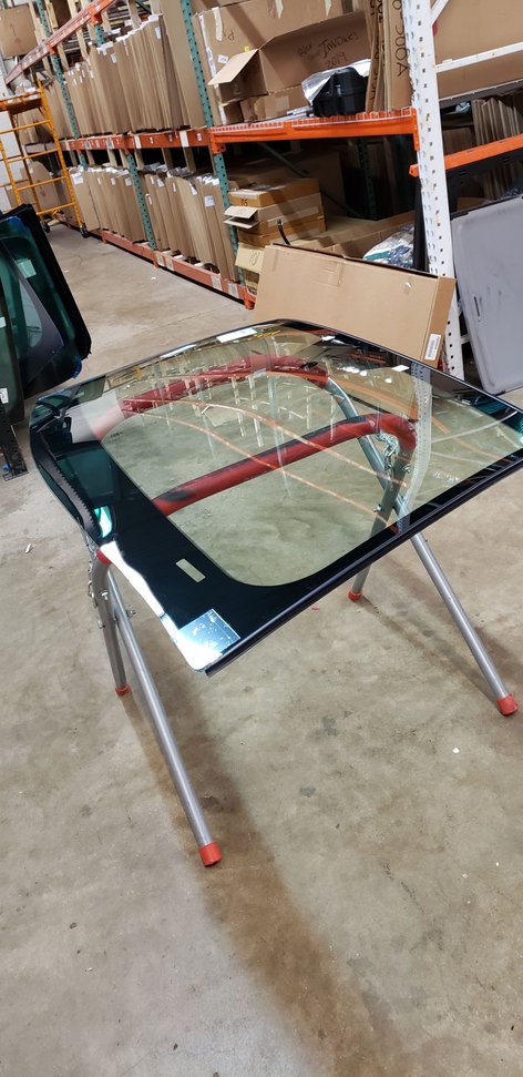

I just wanted to post this up as a head's up for people looking to get new glass.
My original windshield was so sandblasted it was getting to be a safety issue when the sun was directly at it (sunrise/sunset). Like couldn't see anything. So I went to a reputable shop and ordered an OEM replacement. May be a little ridiculous, but I really like the pony logo over the rear view mirror. And I wanted OEM quality.
Well... they don't make 'em like they used to, not even like they did 14 years ago. I got the new one installed, the shop was quick, courteous, and professional. It was a 10 min drive back to work and by the time I got there my eyes felt like they were crossed. Something was off. After work I drove home and it felt worse, like my left eye was out of focus and I had a headache. I picked a reference point and started moving my head around and sure enough there was a noticeable line, like a bend, running right up the glass, directly in front of the driver's seat. Each eye was seeing a slightly different angle and it was messing with me.
I called the shop and they said "Ok, that's weird, we wouldn't expect that with OEM. Bring it back and we'll take a look." Sure enough they saw it too, so they ordered another one. I had to wait a week for the glue to fully cure from the 1st one before they could remove it (otherwise it'd be a mess when they pulled it out). When they day came, we checked out the new glass before installing saw some significant warping on that one too. So they sent that one back and ordered from a different place, and we checked it out. Still significant warping. Can't remember if this was #2 or #3, but if you look at the reflections of the lights and the shelves you can see it.
They ordered a 4th one but sent it back without calling me in. The 5th one they thought was good, so they called me in. Seemed OK at first, but they saw some warping right before they were going to install it. I looked at it closer and yeah there's some warping but not horrible right in front of the driver so I said go ahead and install it. I didn't think it was going to be much of a problem... been a few weeks driving around and it's actually fine. There are times where I notice it but it doesn't mess with my eyes or give me headaches so it's fine. I've also become hyper aware of warping now, I see it in my rear window, my truck, my wife's car, windows at the office, everywhere now. That awareness is fading, I drove it 55 miles yesterday and barely thought about it.
The shop was awesome to deal with and at no point ever gave me a hard time. I'd recommend them in a heartbeat if you're in the northern VA area. The motorcraft glass though... make sure you check it before installing. The shop was telling me there's only a few glass factories in the world now, one in Mexico where these are coming from, one in the US, and a few in China. I guess the Mexico plant isn't as good as it used to be. They said the US one was one of the better ones, but after seeing the special on Netflix ("American Factory"), I'm not so sure. Seems like they had quality issues but maybe that was only growing pains. They said they had the most quality issues with chinese glass.
After reading over your post, it really sucks you had to order 5 different windshields before settling on one that's acceptable enough. Needless to say, I'll make certain when the time comes to replace the windshield, that it's manufactured in the U.S and not from Mexico or China. In the meantime, thanks for your very informative write-up
