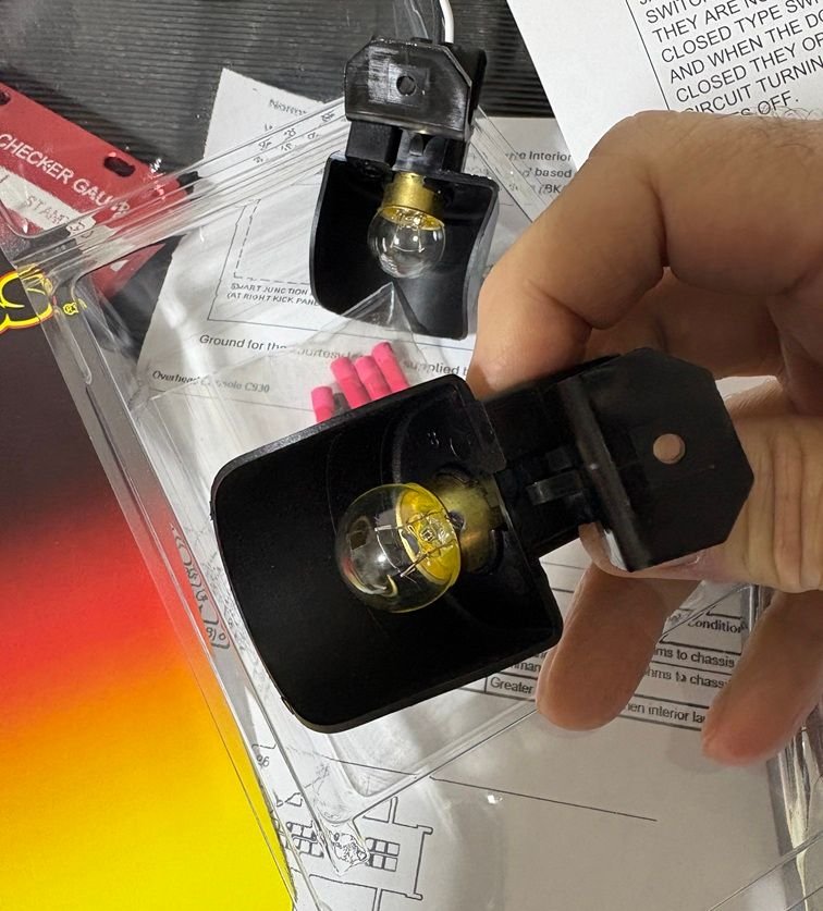

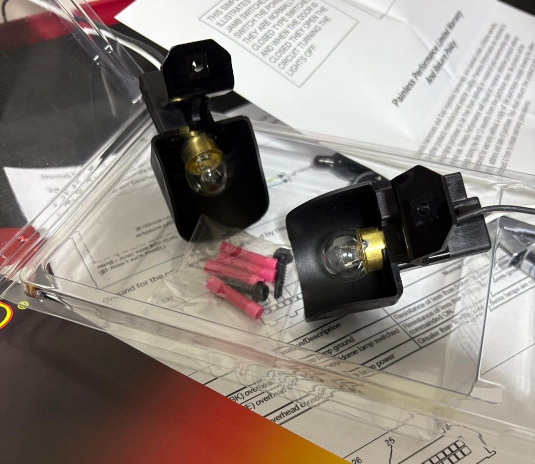

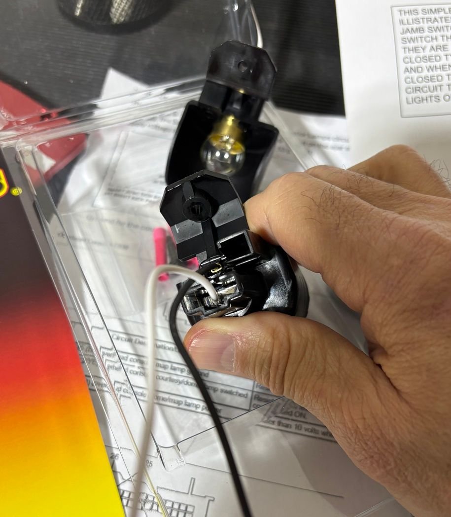

So the lights came in. They are a tad larger than they looked, very well made. I bought these a few years ago for my 64 C10 build, these new ones are better made and black like you see here. Wires are 58" inches long and fit nicely in a 1/4" split conduit. I tested both of them on my battery to ensure they worked. The holes are big enough for a #6 machine screw but not a 4MM. More to come.

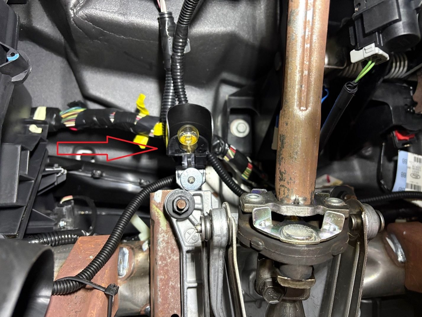

On the bracket for the column mount there is a unused hole where I mounted the drivers foot-well light.

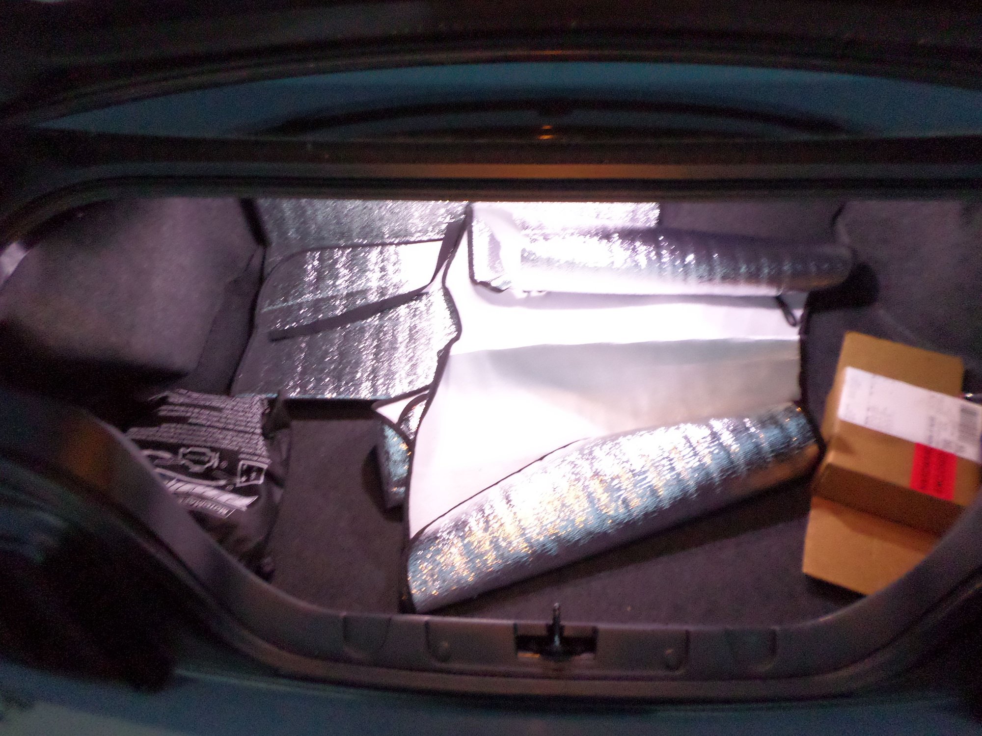

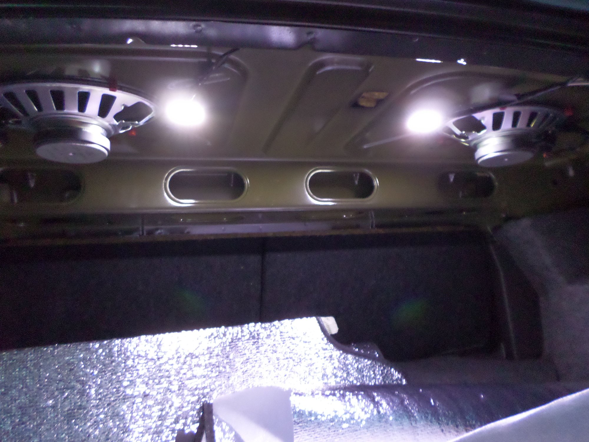

Good job so far. I installed lights in the trunk too. Such a bad decision from Ford to not add proper lighting.

Originally Posted by rocknrod
Nice and bright.
So what wires colors etc did you hook into?
I connected the lights to the trunk light. Then ran wires inside the loom to the lights. That way they behave like factory.

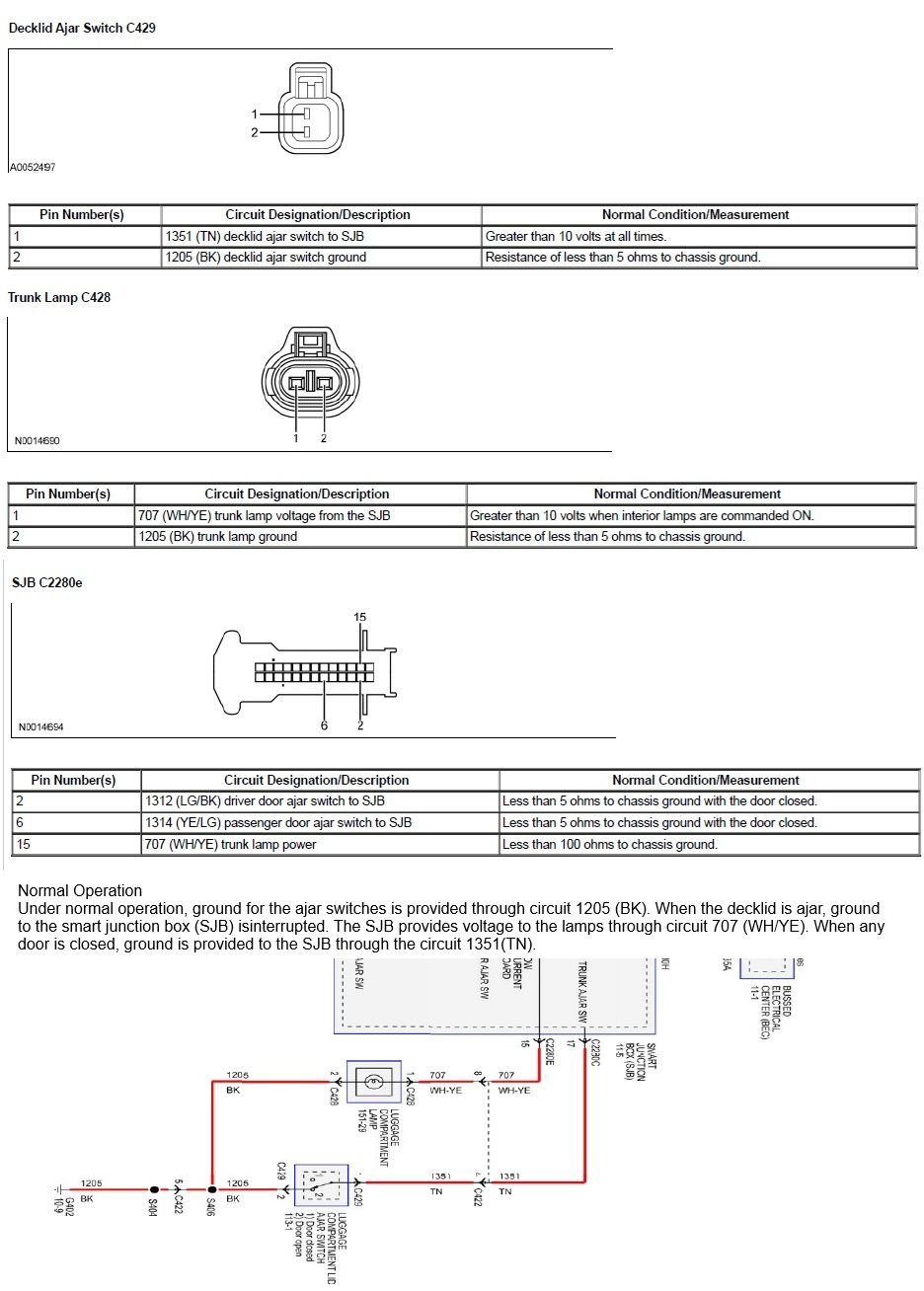

I made a little cheat sheet on the wires a few days ago for the trunk lights.
