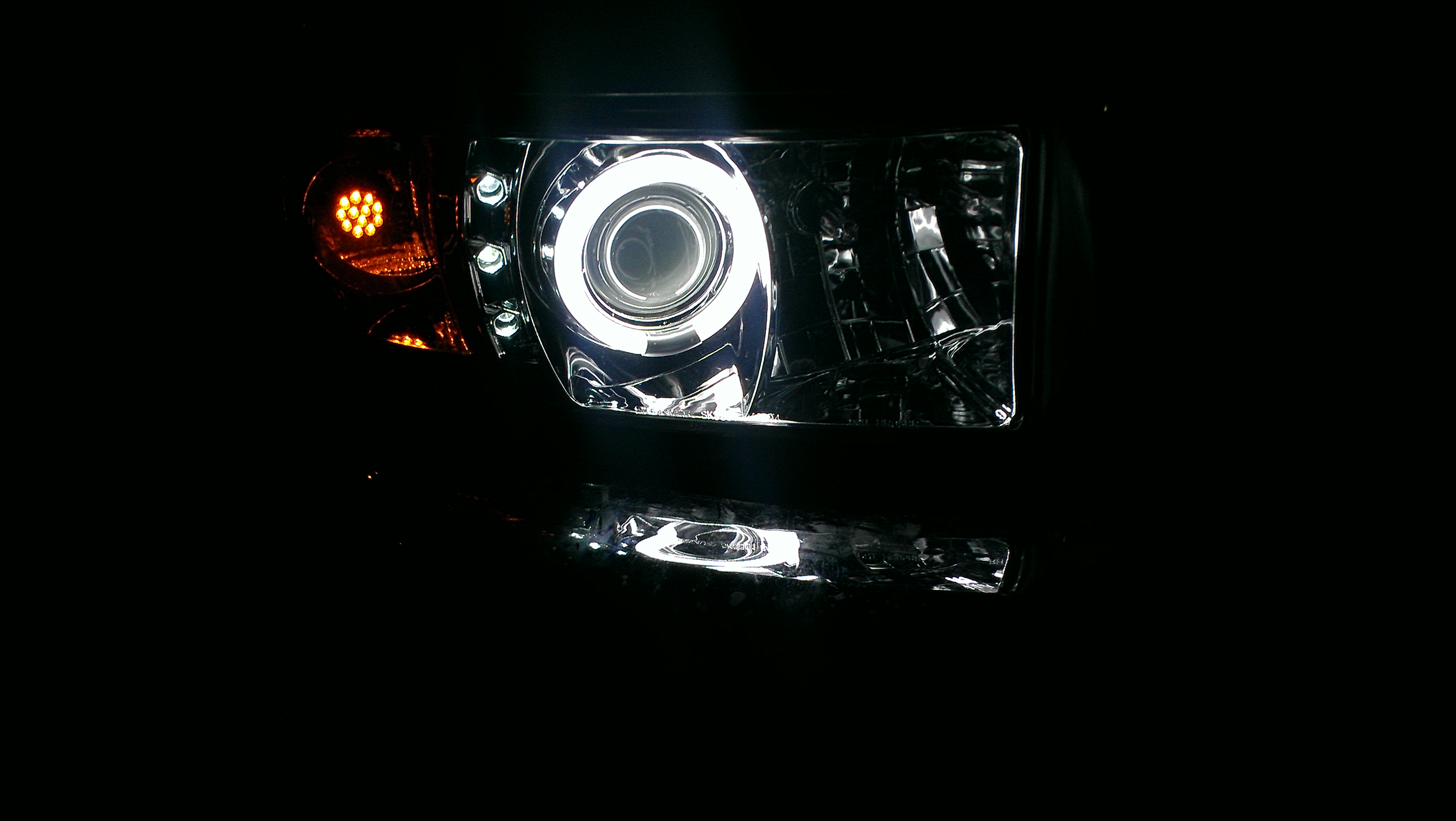

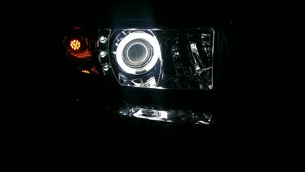

A CCFL isn't a complete circle. I am attaching a picture of what one looks like at night installed. I took this pic right after I installed a pair of Raxiom lights on a Dodge Ram this past December.
When you are wiring the lights with the CCFL you will have two more ballasts to mount. The wiring also tends to be really thin, like 14+ gauge wire. Many CCFL kits appear to be an "afterthought" so you will merely see a pigtail coming out of the light housing with a ballast crudely attached. For this reason I recommend soldering the wires to your 12vdc power source and if no quick disconnects to the CCFL ballasts are included then add your own. Get Molex connectors at your local Radio Shack if you go this route - you'll be a lot happier down the road if you need to replace a CCFL ballast or change out the light fixture.

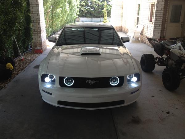

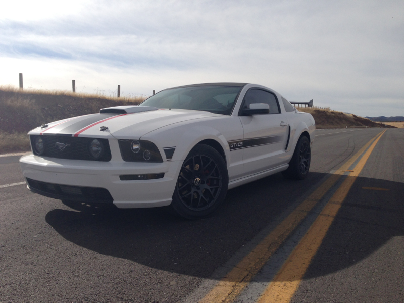

Pics of my car with halo lights with black interior and clear lens
