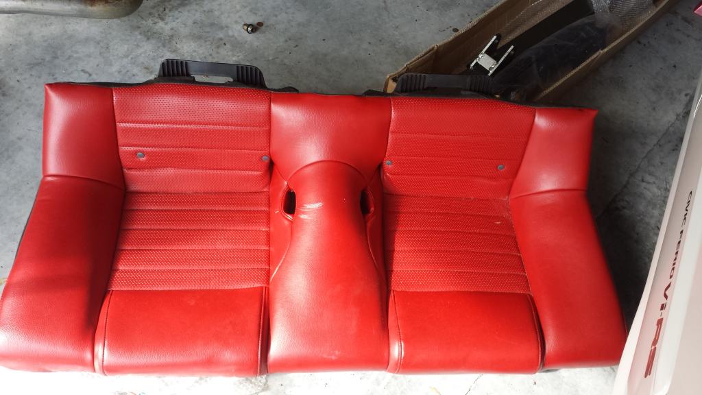

Got there, checked out the seats I cleaned last week to see how they turned out after they dried. Not too bad.

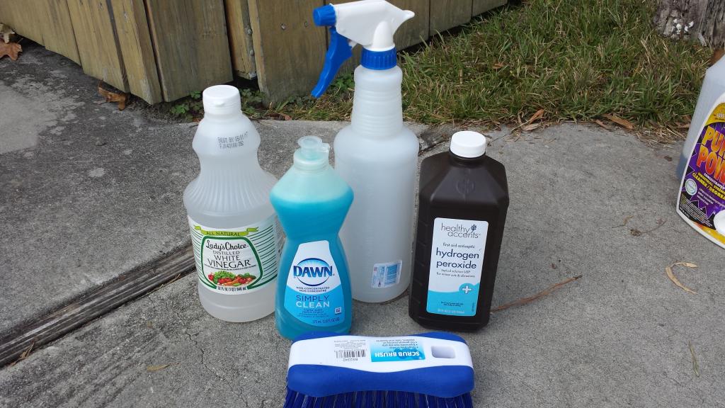

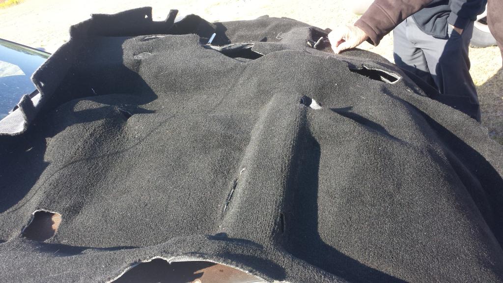

Time to mix up some chemicals. I did some research, and it turns out the white vinegar is really good for neutralizing and killing mold.
Originally Posted by blacktoxicmold.com
Use white vinegar to kill and remove mold in your home.
1. Pour the vinegar into a spray bottle. Do not dilute the vinegar.
2. Apply the vinegar to the moldy surface. You might need to scrub the mold away to remove it totally.
3. Leave the vinegar to sit for about half an hour. Then rinse and wipe the surface with water.
4. The vinegar smell should go after a few hours.

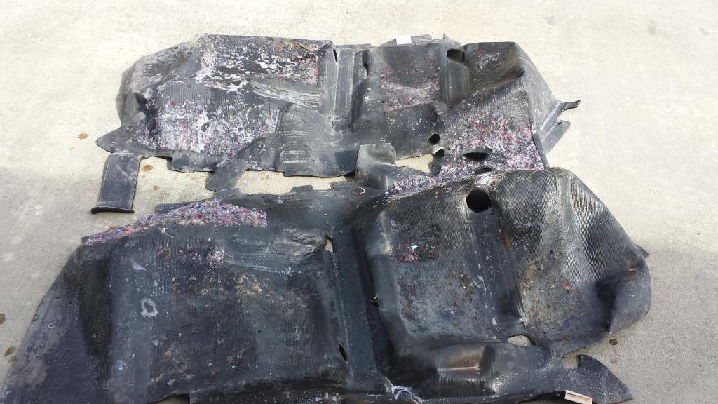

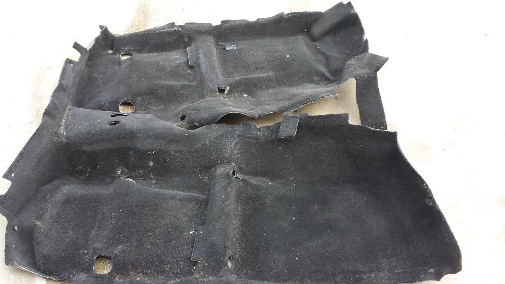

So I poured some vinegar in a spray bottle and pulled the carpet out.

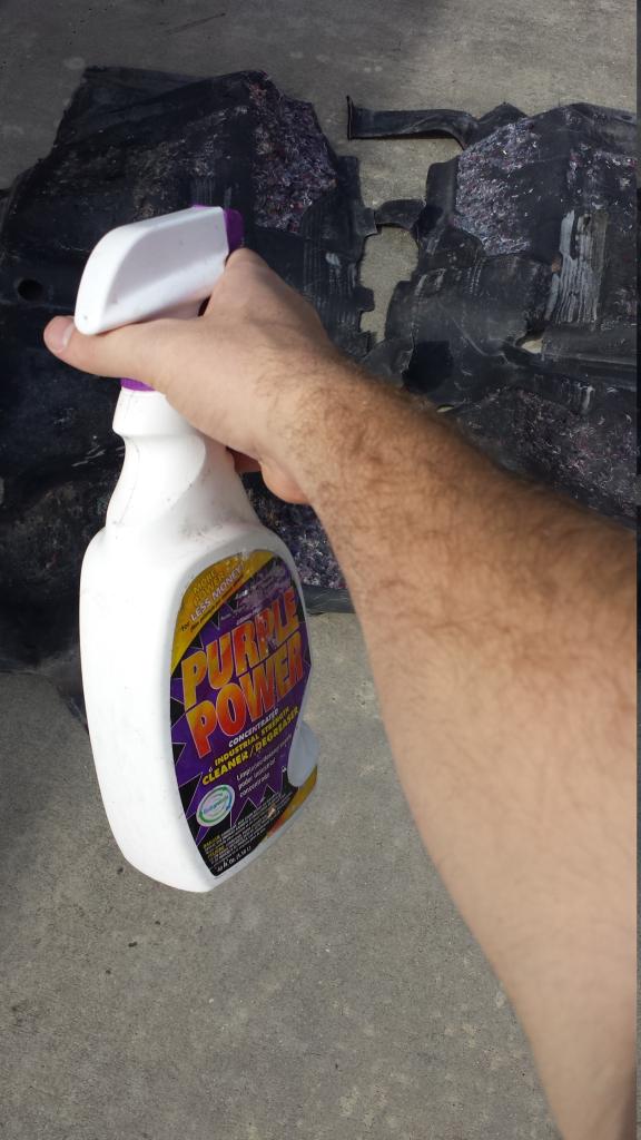

First thing to do is Purple Power that carpet and let it sit.

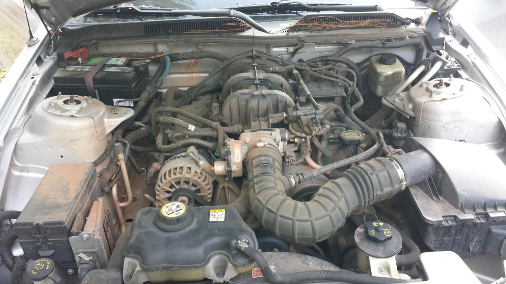

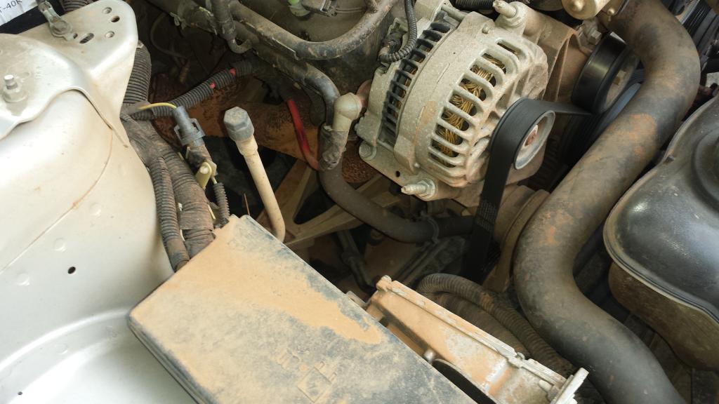

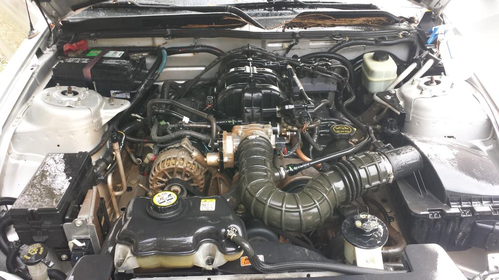

While the Purple power is soaking into the carpet, I thought I'd go check under the hood. Not concerned with the dirty yet, just want to make sure it isn't leaking oil.

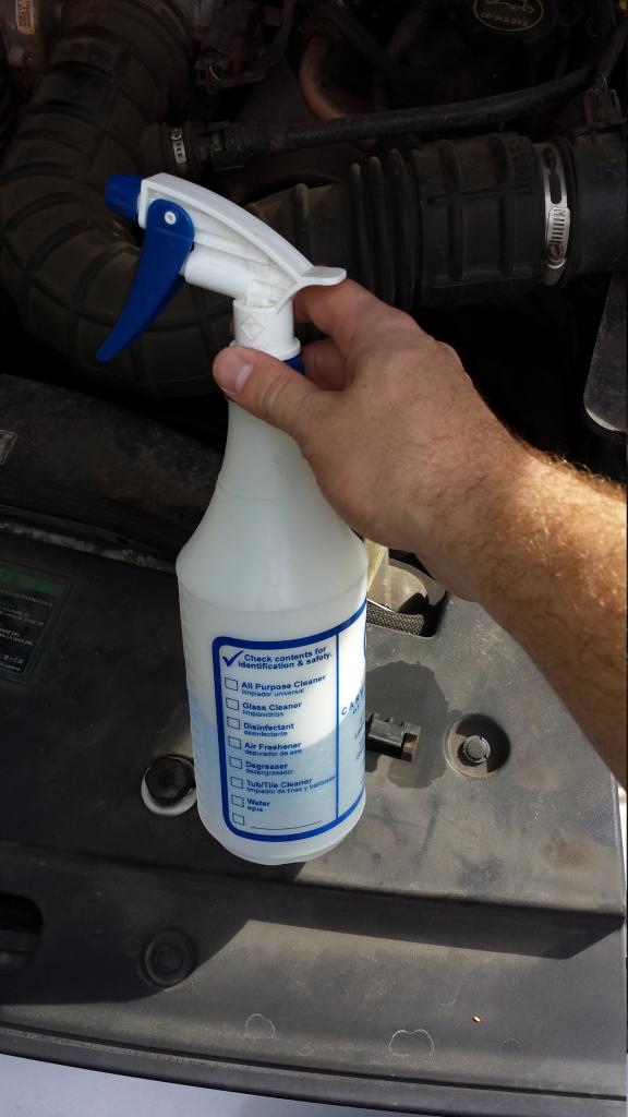

So I got some Deep Purple from my old boss and went to town on it. It still needs to be scrubbed with a small brush, but for now it isn't caked in dirt and I'll be able to see if it's leaking anything anywhere.

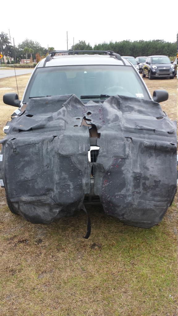

Now that the carpet has sat for a while, it's time to cover it in vinegar. Both front and back.

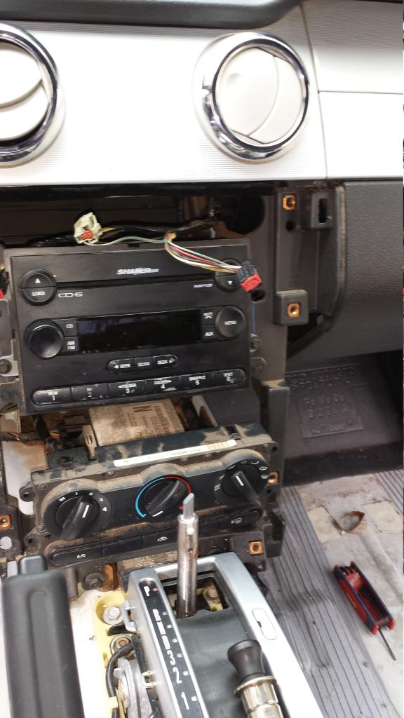

So in the mean time I decided to get back to work on the inside. You may remember how there was something on under the stereo/climate control I couldn't get out. Looks like whatever it was, was superglued almost.
(previous pic for reference)

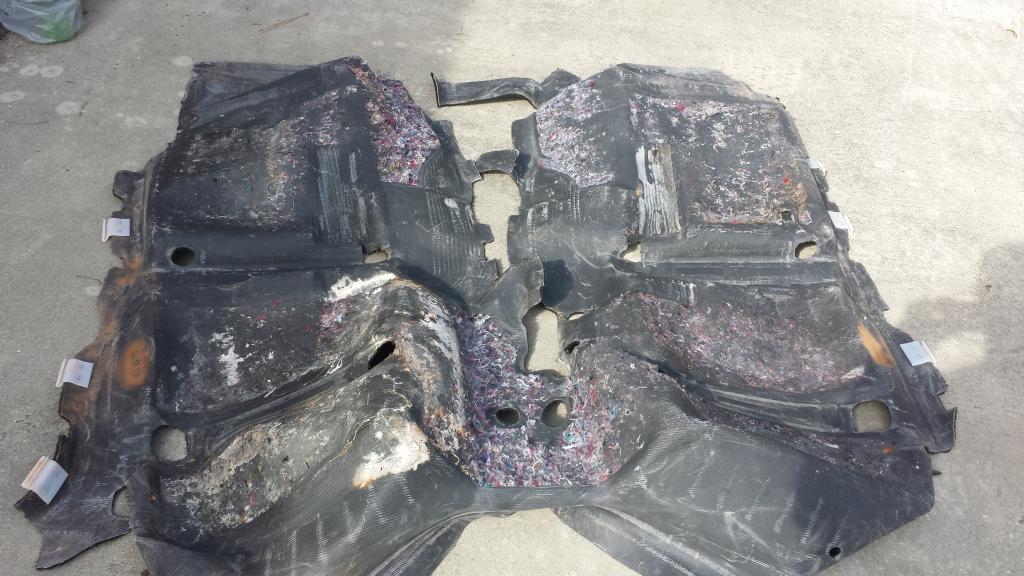

So I decided to take that whole piece out.

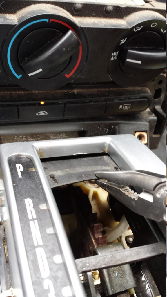

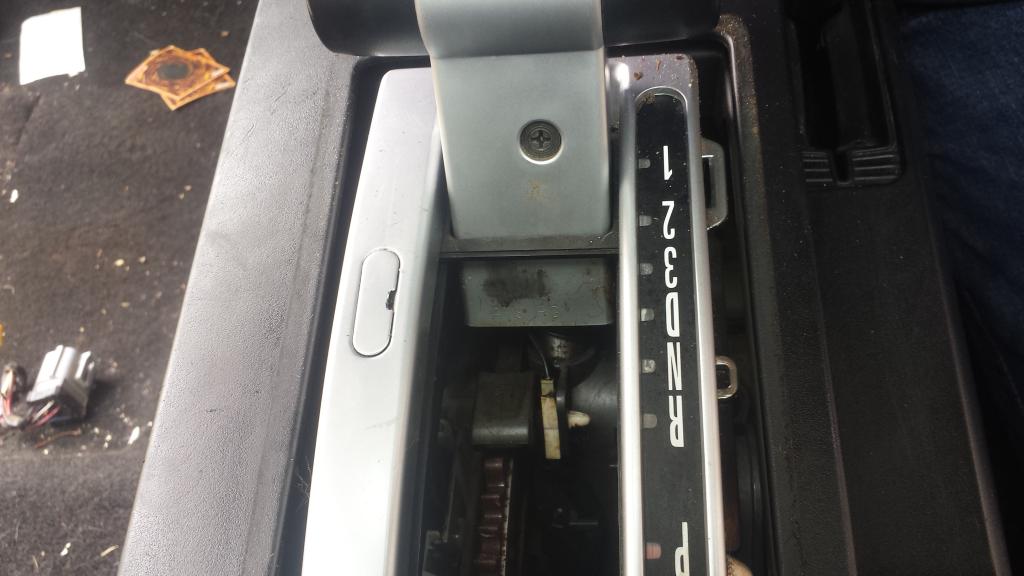

Since I needed to let the vinegar sit for a little longer I took a look at the shifter. Remember how it was super gross inside with ketchup packets and stuff? Well it was because the cover for the top of the shifter was broken.
Well it turns out that the cover piece was just stuck back up in the shifter. So with some needle nose pliers I was able to pull it out. Unfortunately you can see I nicked the silver plaster trim a little bit, but I think I can take some fine sand paper and sand it down softly so that it's not even noticeable.
The good news about that is that the top cover also controls the little red piece that tells you what gear you are in, so it won't be permanently stuck next to the P now. I think 2 tiny dabs of Krazy Glue and I can attach it back to where it goes.

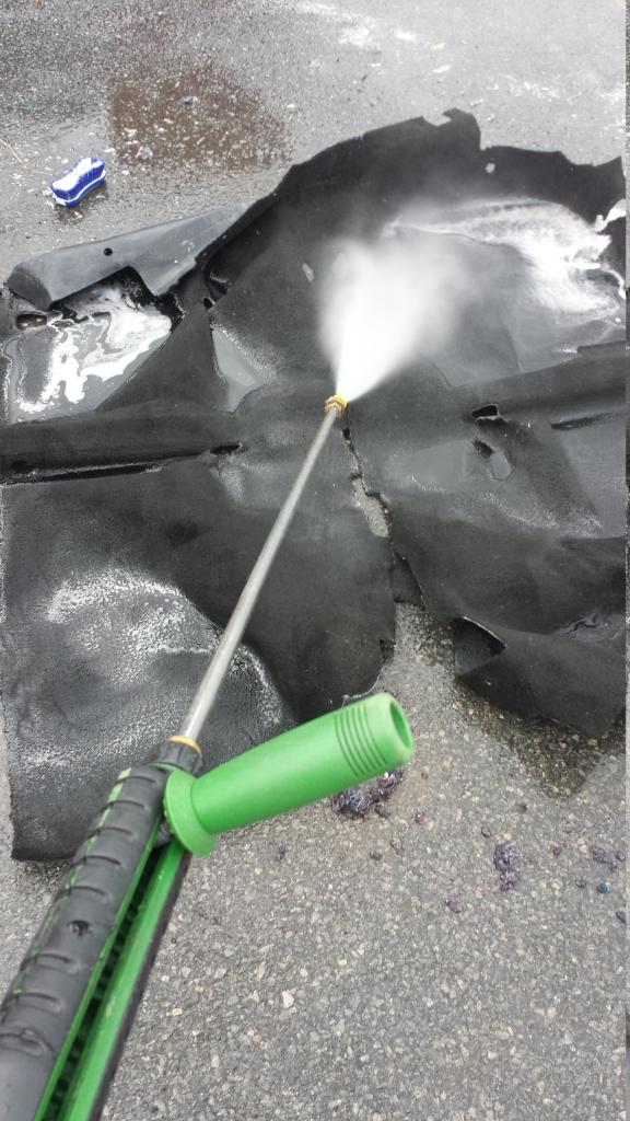

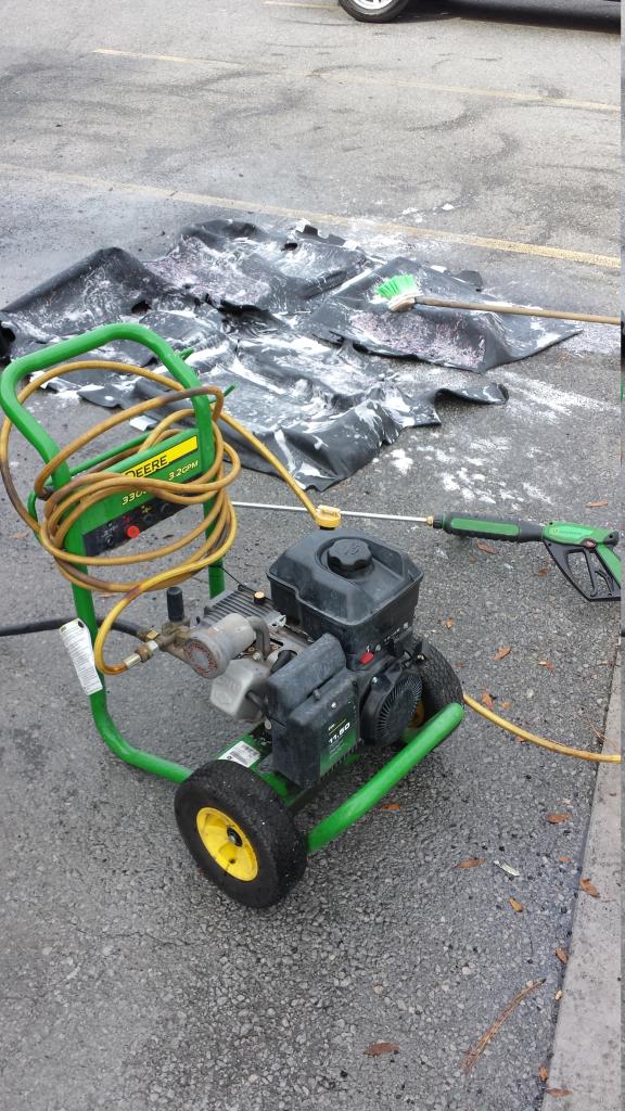

Now that I'm done with that, I threw the carpet in the trunk of the Saturn and drove it up to my work.
Pulled out the pressure washer and a scrub brush. Soaked the carpet front and back in the "home made carpet cleaner" (dawn+peroxide) and used the scrub brush to go to town.
For some of the parts I had to break out the poly bristle brush and really scrub it good.
Pressure washed it all down.
Then laid it out to dry.

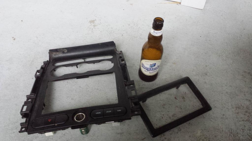

Got home and pulled out the pieces I gotta sand down. That's the trim that goes around the stereo/climate control as well as the trim that goes around the shifter. Unfortunately I broke two tabs on the trim pieces, here's to hoping I can make do without them.
Gonna sand these down and paint them later this week. And what car project is complete without a good beer.

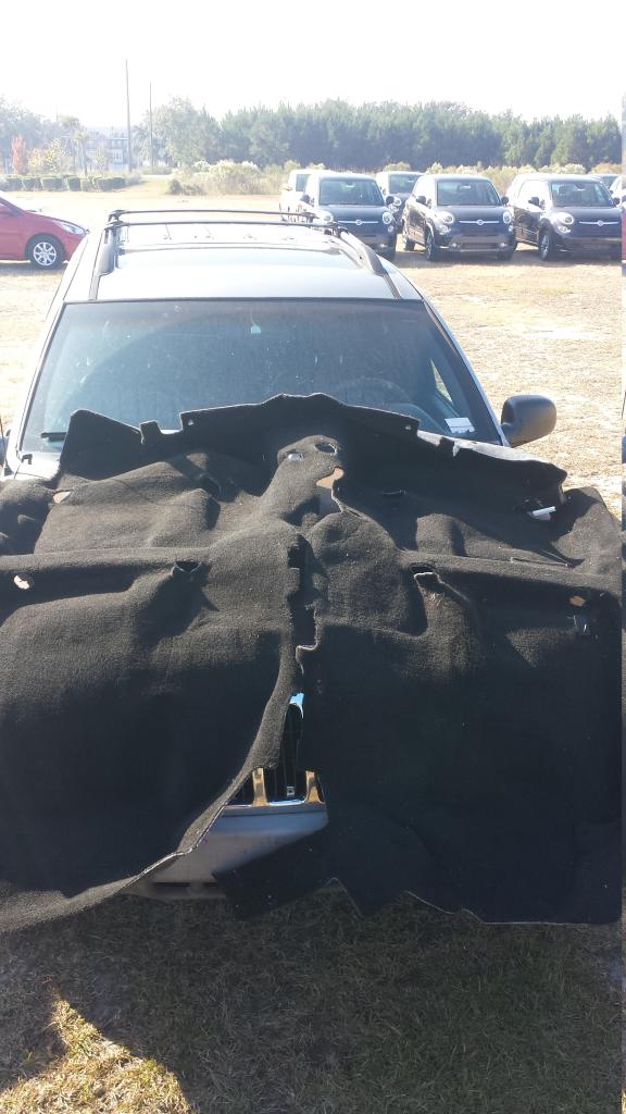

Just flipped the carpet! Came out great!

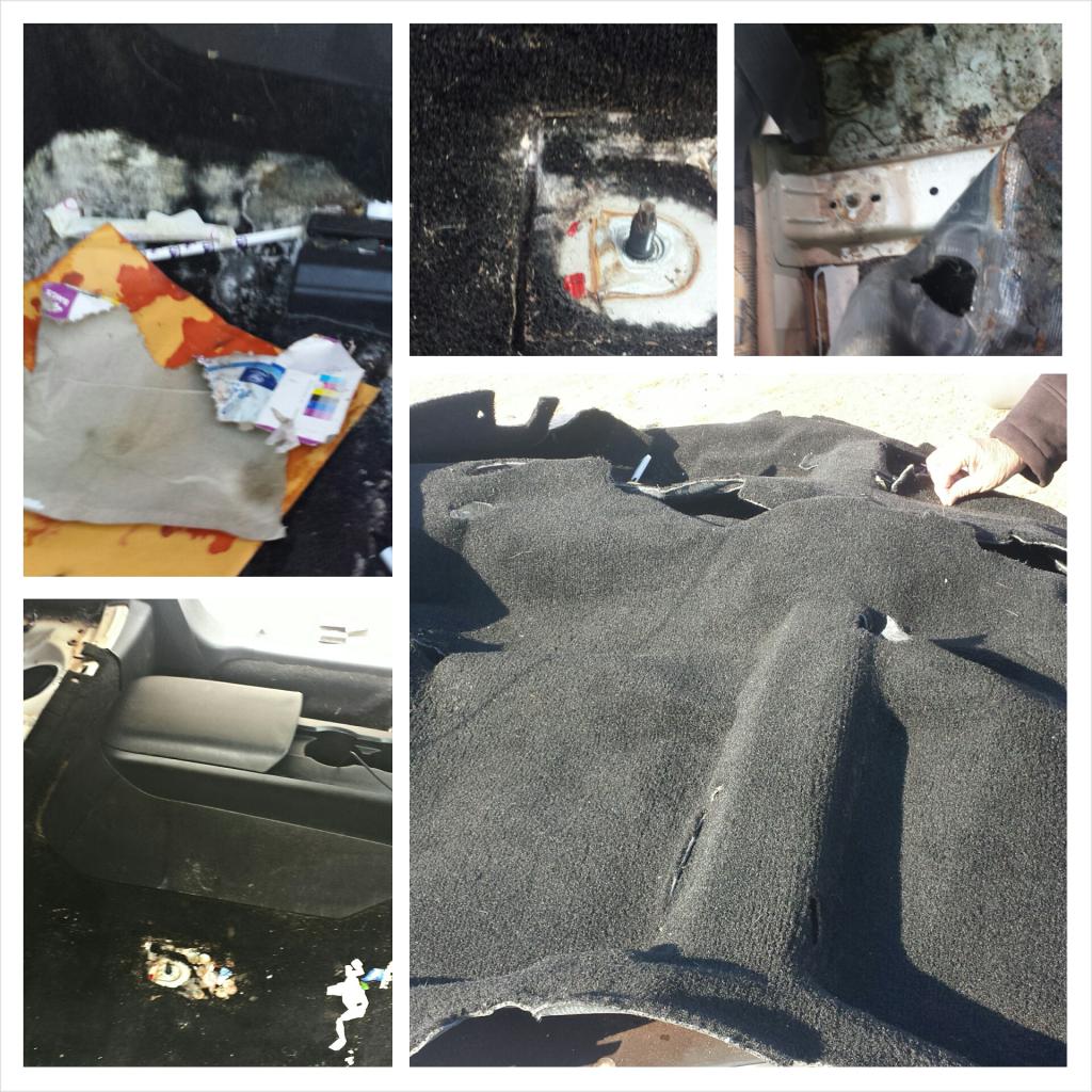

And incase you've forgotten how gross it was.
