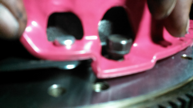

Putting in my new ram clutch and ford racing flywheel and the clutch is not seating correctly. Its like my stock clutch bolts seem to be to long by about 1/4".
Anyone have any similar issues?
Anyone having the same issue as this, if the m8-1.25 bolt doesn't fit go to a 5/16x1.00" problem solved
