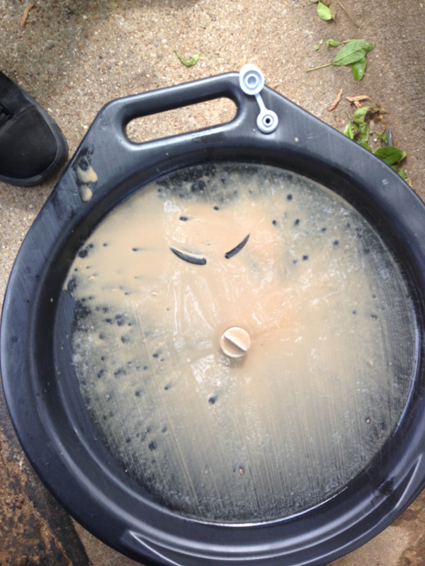

A few days ago i was driving home from work and the weather was pretty bad.The streets were filled with water and my car managed to somehow suck water inside the engine.From the intake i belive.Anyways,it started knoking loud and idk what could be wrong.My friends tuner reads misfire on culinder #8 what can i do to fix this knoking!

Thats my oil before finishing the oil change

Sounds and looks by the oil that the engine did suck in water, and hydrolocked. You most likely have a bent rod and shattered piston at the least. Seen in lots of times and that oil is a dead give a way. You're gonna have to have a complete engine rebuild, and probably some machine work on the block and heads
