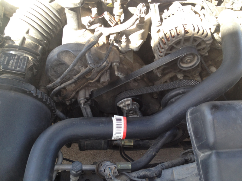

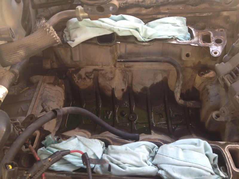

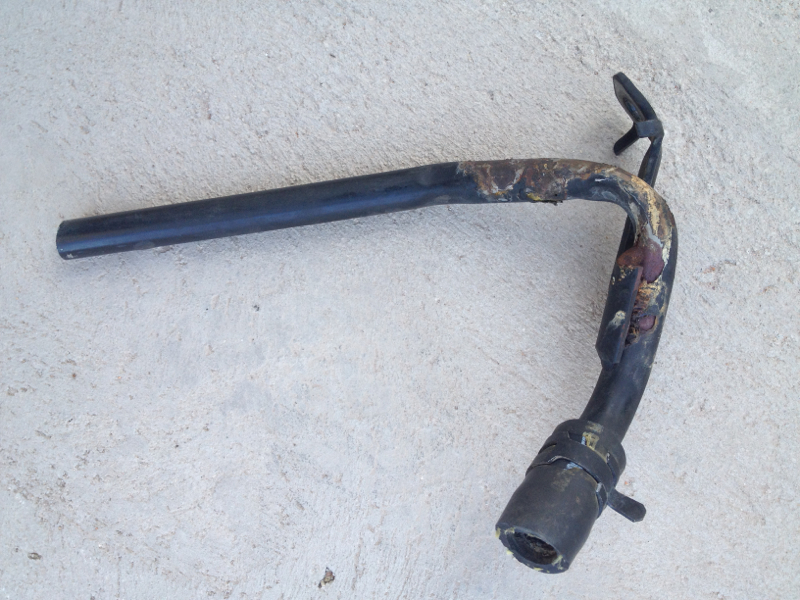

Finally repaired the leak, the leak was coming for a tube that comes from water pump and goes thru the block (under the intake) also replace gaskets and added some silicon to assure the poor intake plastic
