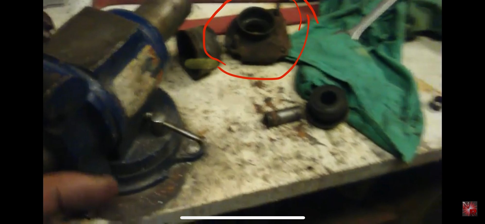

I bought a 95 GT and in the process of redoing some things and it has very cheap coilovers on it and plan to put regular shocks and struts back under it. In the process of ordering parts I’m having a hard time find the top hat that goes through shock tower. Does anybody know where I can find 2 of them at? Or is there an alternative? I attached a photo of what I need.

You reuse the metal parts of the strut mount, take it apart, clean the metal up, and rebuild it with a strut mount bushing kit. Here's the things you are looking for:
https://www.rockauto.com/en/catalog/...rut+mount,7600
Alternatively, you can get caster/camber kits that'll replace the entire thing:
https://lmr.com/item/SVE-CC9404/sve-...er-plates-9404
But depending on your application, those might be overkill. And by the way, those are all examples, not recommendations, you buy what/from where you want to on those things.
