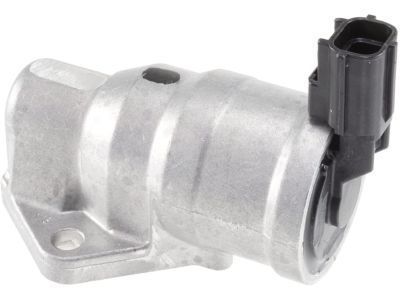

The Whining & Wailing Sounds Like Air Bypass Valve. It Controls Idle Speed. You Also may have a Vacuum Leak & Need to Check all Vacuum Hoses to Start. Get a Helper under the Hood at Shut Off & Try & Pin Down Sound. Shut Off Sound Could Be A/C System if you are Using It Currently. It's All Process of Elimination.
KC
Air Bypass Pic For You! By Throttle Body.
