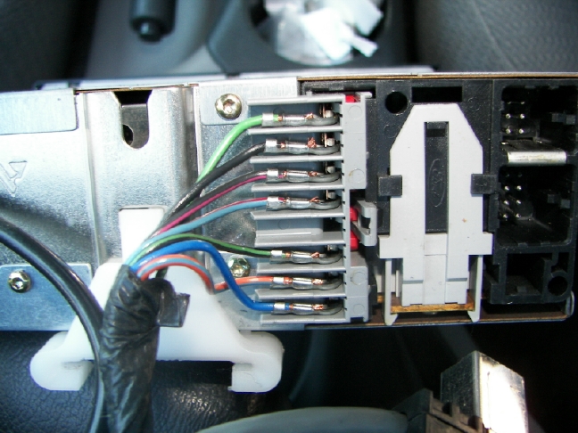

Here's the back of the factory radio...these are the wires you need to look at. There are two wires to the left in this pic (on the right, if you are looking at the radio from the drivers seat), one is the amplifier and the other is the antenna. There are also two cables on the right (detached in this pic, on the left if you are looking at the radio from the drivers seat), I'm not sure what they do (I think they are to the speakers). but they don't have anything to do with the front display, as I detached them and it was still lit.
That leaves the seven wires in the middle (which is behind a black cover that pops right off, not shown in this pic), one of which I bet is your problem, like mudshuvel explained. The only problem is that it might not be on this end, it could be at the other end when the wires tie into the power.
Hope this helps!

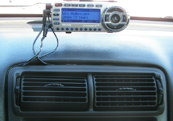

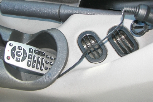

Here's my Sirius Satallite radio. The '00 model year was really favorable for hiding all the wiring, I think. I hid the antenna wire from the roof underneath the windown molding outside the car to the trunk. Then through the trunk, inbetween the seat and the interior paneling.
Then I fished it under the kickplate to about halfway up the door, then under my seat and under the transmission console. From under the tranny console, I ran it up to the seam in the center console and just tucked it around the seams near the radio and the a/c vents and out the top, to the head unit.
The power supply I ran from the power outlet on the arm rest and underneath the cup holders, which also pop right out (and if anyone knows where I can get a better aftermarket cup holder, please let me know, because this one is SO ugly!). From underneath the cup holder, I just ran it the same way as the antenna.
I also added an FM modulator, which cuts off the car antenna and directly feeds from the satallite antenna (HUGE difference, the only way to go, in my opinion). I ran this from behind the radio, and in the seam up the right hand side of the center console (opposite of the antenna and power lines.
All three cables came out at approximately the same spot and plug into the Sirius head unit.
