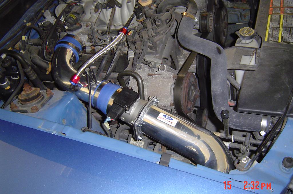

Got it installed, thanks for the help
Even without directions, I just looked at the picture and I installed it.
Attachment 2368
I had a Ford Racing sticker, so I put it on it. She is very happy with it.
I had to get a longer crankcase vent tube, so I used some old braided hose I had used on my 06 and put it on. It really helped a lot for the looks.

Looks good, and the braided hose is a nice touch too. And nice sticker too! Looks familiar...
