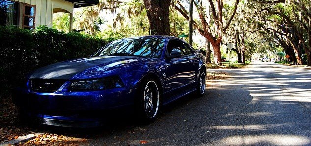

Some things have been seriously bugging me lately and I want to get them fixed. (a lot of that is my hood that suffered a rock chip that turned bigger) I just wanted a thread where I can get advice, opinions, ask some questions and maybe some constructive criticism to get my car looking the best again.
I understand she's a daily driver with 125k but I'll likely be keeping it for awhile. I understand that you can't keep a daily driver perfect. I
Well, first question. I want to sand the whole hood down for repaint. What grit should I use? Or are there multiple ones that I should? Any techniques?
2nd one, will 275/35/18 fit on a New Edge lowered 1.5? (eibach pro-kit)
3. Wheel spacers? Should I?
Again, thanks for the input and sorry if the questions are "stupid", I'm still learning here.
Thanks, Amie

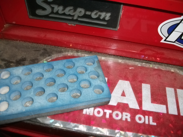

that is the real truth. talk to your painter. you want to remove any traces of wax. dont use any silcone products of any kind around your car prior to any painting. your gonna want some sanding tools. i like air tools like DA sanders and flat file sanders to do most of the grunt work. there are electric tools that will work too. if hes only gonna spot prime the chip area, sand the chip area flat over the chip area, meaning not digging into it. you might need some spot putty if theres any dent there. that usually gets worked out between primer coats. your gonna want to feather that out and take all the old paint down to no signs orange peel. so you want real smooth.
if hes gonna prime the whole hood, you can really take the paint down more. sanding primer is more critical as its soft and any little sanding marks or gouges in the primer will show in the paint. the primer will need to be wet sanded and you will want to use sanding blocks to keep flat areas perfectly flat. curves are tricky too and the hardest area to sand. you`ll want some rubber blocks that flex for curved areas to put your sandpaper on.
might do some homework on it and google car painting and prep work. if you have any auto paint stores around that sell paint and supplies, those people are great to talk to and can set you up with lots of info and some supplies, papers, sanding blocks ect. its a art in itself, but doable if you really put your mind into it
heres a example of a hand sanding block ive used. its a good block for water with the holes in it and it flexes a little for some curves, yet is very flat for flat areas.

Awesome!! Thanks!! I'll definitely research it and thanks for the examples I really want to learn all of this stuff and do my own projects. I like anything artistic so hopefully I become good at it. I'll definitely be watching him paint it. He will likely handle the primer.
