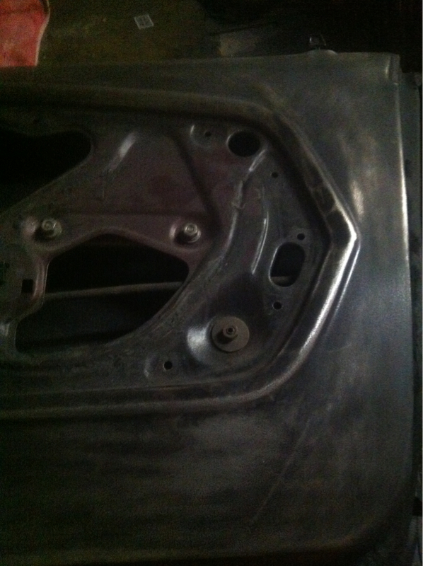

What type of paint do i use for my doors?

So that it sticks

Buy the SEM paint at National Parts Depot. I used that crap from mustangs unlimited and it was a mess.

The paint to use is the same paint for the outside, overall. Depends on if you want a shine or not. Semi-gloss is probably what you're after, but if you can use it on the outside of the car, then you can use it on the inside. Prep is the same: Bodywork if needed, sealer primer (probably a thin coat for the grainy skin) and then shoot it.
