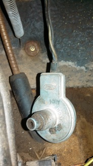

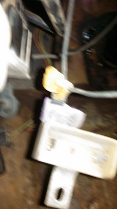

Found under dash just hanging there (See Pictures)

What year is the car? There is a part number visible in one of your pictures I just can't read it. Looks like it starts with D0 so I assume you have a 1970. Get the part number and Google it.

Mat the worked one is under dash light and the other is part of a censer
