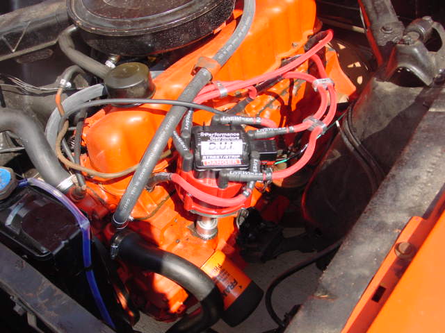

I just added an electronic ignition to solve the point problem and anything else that goes along with it.
Cheater!!!
Of course, this is a good idea.
I am just kinda old school and very used to playing with points etc.
