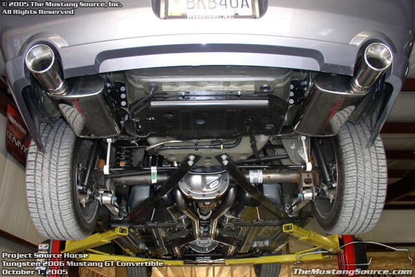

The
BMR Boxed Subframe Connectors and
Magnaflow Cat-Back were installed today, and PSH made its second
trip to
Walker Dynotune tonight to test the power increase the cat-back
provided. More on that in the coming days.
