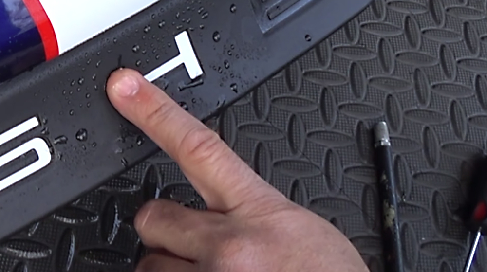

Installing Shelby lettering vinyl on GT350 and GT350R Mustang front lip / splitter
After drying the cleaned letter indentations with compressed air, Solis warms the area up with a heat gun. Vinyl adhesive curing and cold weather don’t get along great, so a warm surface is beneficial. Before applying the letters, he liberally sprays the indentation with distilled water to allow the vinyl to move. Once the vinyl is in his desired location, he once again uses the heat gun along with a soft plastic pick to coax the remaining water out from beneath the letters.
