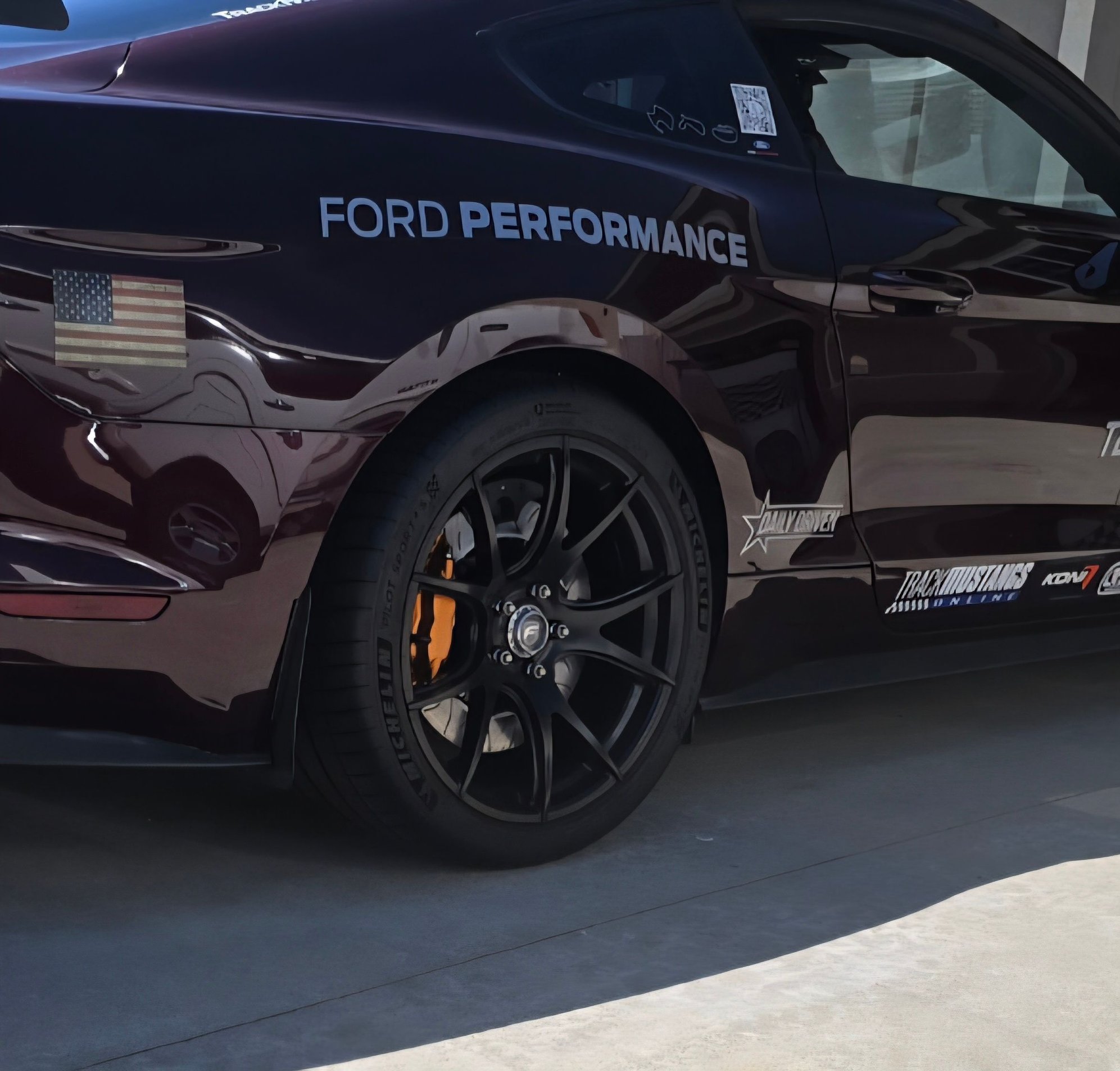

I decided to get rid of my ugly rear calipers. So I found a company named BGR and they put together a rear only kit that will allow me to have a parking brake that didnt brake the bank. is the install video I made for them.

Looks pretty nice, sturdy and light weight too I’ll bet.

yes they are. I didn't weigh the components but by the old arm scale will verify its at least 30% less.

Here is what the finish product looks like installed and ready to hit the streets/track.

I Like What I See!

Just drove the car up to, around and back down the arrowhead mountain area. Brakes did great. I will call this a good mod for the S550. If anyone has any questions on this please let me know
