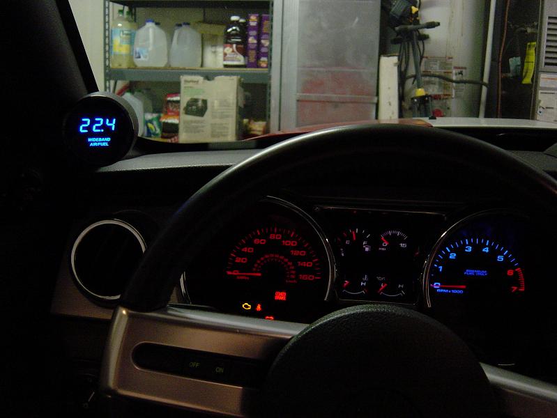

I bought my GT500 cluster from Tousley Ford for $223 + shipping. There was a $300 core charge. The "expense" is having the dealership install it. They must do this because the "data" must be downloaded from your existing cluster onto the replacement. My dealership charged me $190 for 30 minutes of work .

a) Love the speedo on the left. I've been driving third gen Camaros for about twenty years and I'm used to this. Never could get used to looking to the right to check my speed..
b) My-Color has an additional setting not seen on the GT cluster: R-W-B. Here's a pic.
c) I originally thought the shift light had to be activated / set on the tune file. I was wrong. It can be programmed with the message center buttons. The light itself can be turned on/off. The audio chime can be turned on/off. And most importantly, the rpm can be set also. This function is independent of the rev limit which is set in the tune file.
Dislikes:
a) Only one. Don't like the background color. It's a light shade of charcoal and in bright sunlight (especially with glare off the lens), there isn't much contrast and very difficult to read. Now if someone were to make a black-faced GT500 overlay..... we're talkin' now!
