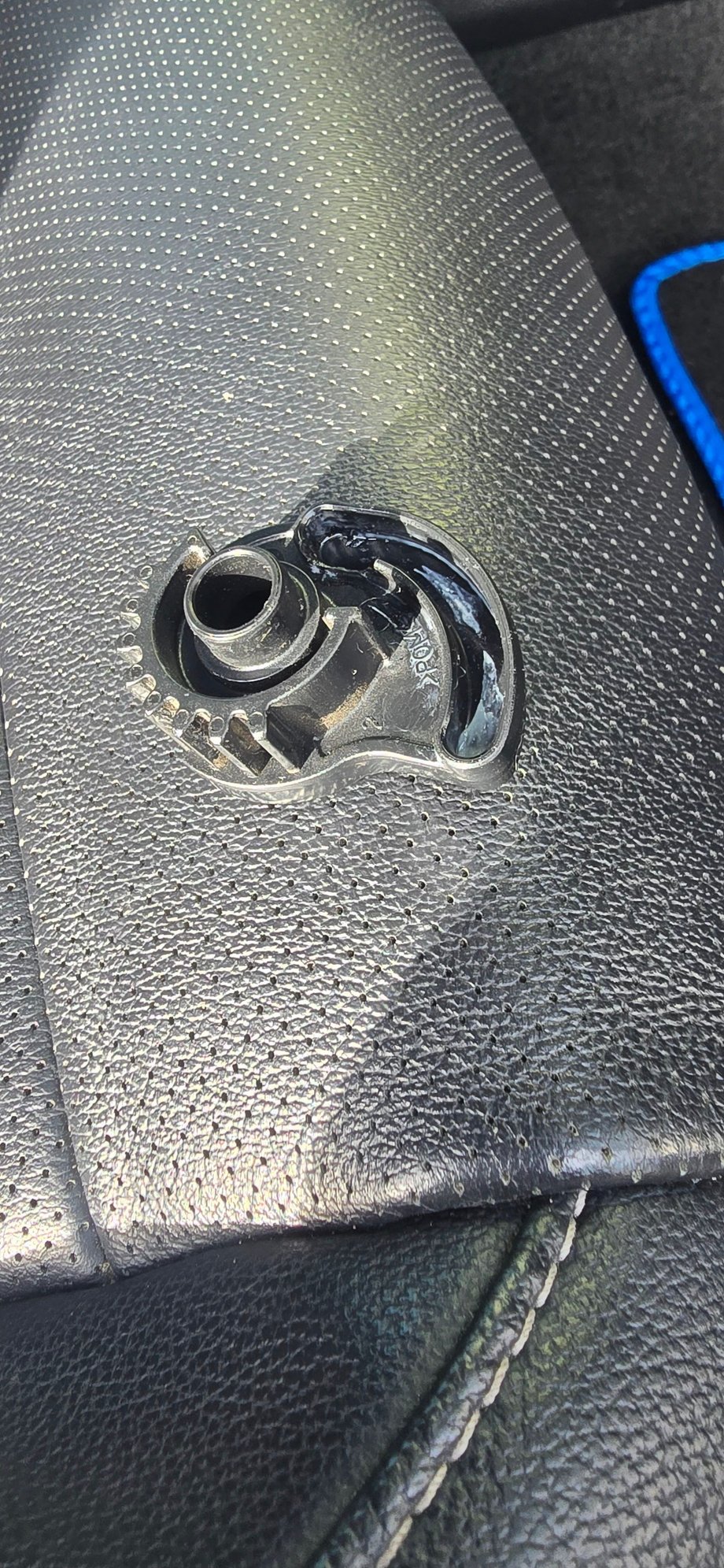

Hi everyone I have an issue with my drivers side blend door actuator had failed and been replaced and is working but the cam gear it slides on to is cracked and I can find a replacement part anywhere. Any ideas? I can upload photos if that helps.
thankyou

It is Doubtful It is a Separate Service Part & Likely Comes With a Whole Heater Box, But We Can Try. If The Part has Any Numbers Embossed in it Such As {Fr3b-19E620-ab} Example of A/c Service Part Number, That Would Be Helpful. Yes Some Pics Would Be Great. Close Up And Pulled Back For Perspective Would Be Nice!

hi thankyou yes there's no part numbers i think I might have to have it 3d printed.

If You Had The Broken Piece Some Good Epoxy Could Do The Trick But if You Have 3D Printer Accesss That Would Be Better.
If I Come Up With a Part Number I Will Advise But I'm Doubtful!
