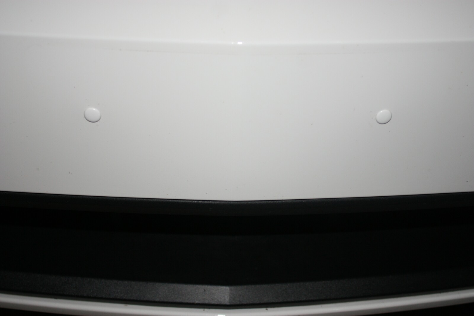

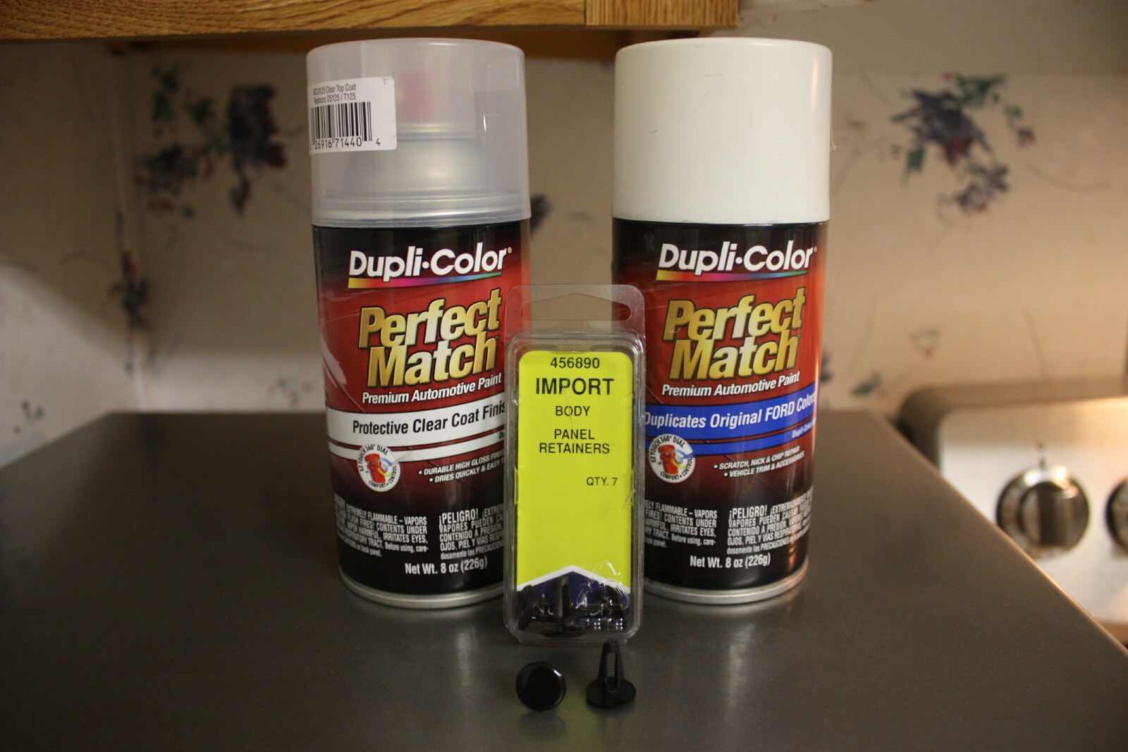

I noticed earlier in the thread some members were talking about covering up the holes left over from the plate bracket. I'm sure others have used similar methods to cover up the holes, but I thought I'd post what I did.
My car came from out of state from an area with front plates. I picked up some body retainers from O'reilly Auto Parts, part number 456890, some factory performance white, and a can of clearcoat. The retainers were $2.49. The paint was around 7 bucks a can.
First I carefully Dremeled the edges of the holes in the bumper where it was pooched up from the self-tapping screws so it was totally flat, and I touched it up so water couldn't get under the bumper paint.
I scuffed the parts store retainers with red scotchbrite and put 4 light coats of color and 2 coats of clear and let them dry. It's a spot on match for the car's color. They just pop right in and stay on their own. I still need to run some compound on the bumper where the bracket scuffed the paint a little, but it should polish right out.
It doesn't make the holes go away, but it's way better than it was and is a pretty cheap and easy fix.
