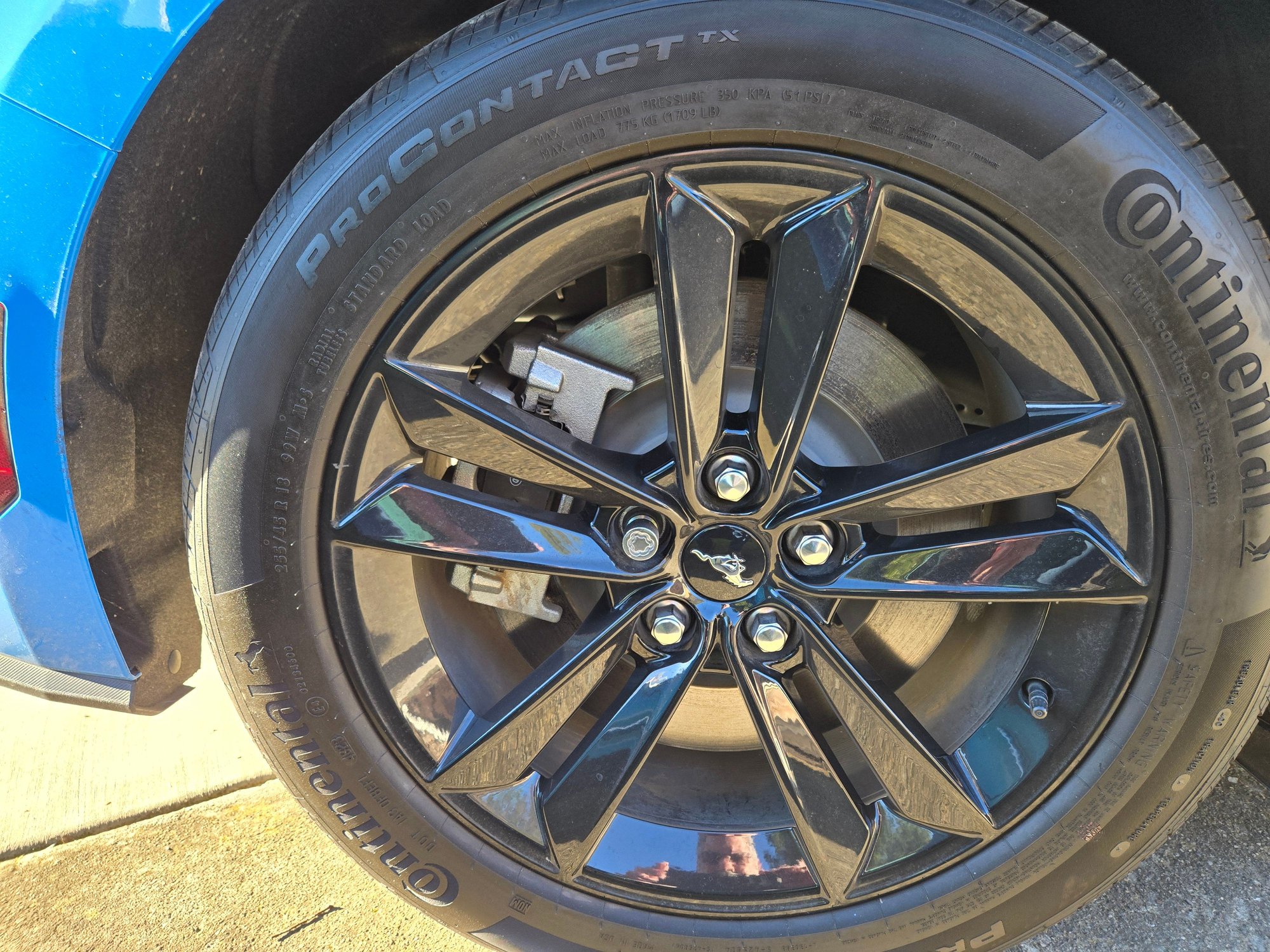

OK, think I found the source of my confusion but am no closer to an answer. First to the photos: (note: front is to the right)
Front brake-
Rear brake
My confusion comes from the little/tiny "Brembo" on the front brake caliper at about the 10 o'clock position. And there's nothing mentioned on the rear brake caliper. Do I treat this as a performance brake package when I order the spare tire? No where on the window sticker or supplied paperwork does it mention a performance brake package as part of the build. I'm ok with just ordering the Dark Horse/performance spare tire version in an abundance of caution its just that I'd like to not spend the extra bucks for it.

Looks Like The Big Boys To Me!
So Regardless of Rear You Likely Need The Big Brake Kit! The Big Kit Would Work on Either I Would Surmise While The Standard Kit Would Be Base Or Standard Gt Only.
Again PM Me Your Vin & I Can Shed More Light.
I Know on earlier Models The Brembo Brakes are Front Only. Have Not Researched Rear. Regardless It Clearly States Brembo on Caliper!
KC

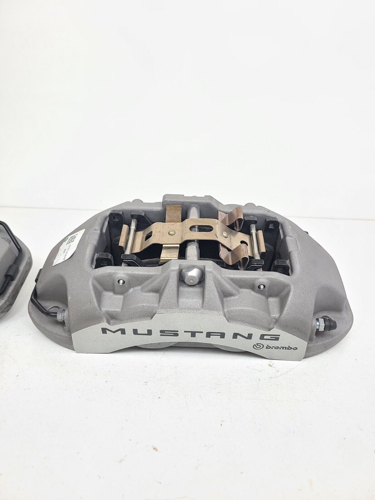

Ok, I Had To Keep Digging. The 2024 Mustang Appears to Have Brembo Brakes & 4 & 6 Piston. Yours Look Like 4! See Piston Outline.
Should Have Known To Look Outside Ford Data Base For Better Pics!
KC
4 Piston
4 Piston
6 Piston
6 Piston

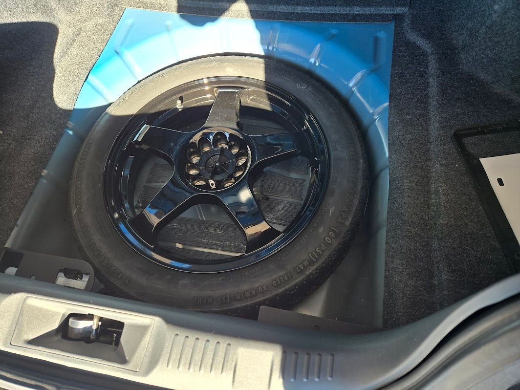

And in conclusion. It fits like a charm, no bump in the trunk floor. The only thing is that the jack and tools don't nest under the tire or out of the way so I'm going to have to go with a trunk organizer. The last test will be if/when I get a flat but I can wait for that. Also got the same kit for my wife's Acura TLX which likewise didn't have a real spare but DID HAVE the same inflator/tire goop setup as the Mustang. It also installed without a problem. Unexpectedly I now know where the Acura's battery is-in the trunk and inside of the spare tire well. So far I'm impressed with Modern Spare's product.
Thanks all
