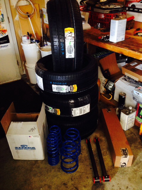

After a season of racing in F stock class in SCCA solo2,
and winning a championship
I have decided to change some things!
This is a daily driver so I have hopefully put together a parts list that will handle track days and daily driving chores as well!
So far I have
Steeda sports springs.
BMR lower control arms.
New tires 275/40/19 P Zero's
The taller tire will help my gear ratio a little better ( wish I had 3.55 gears)
(I know lots of people do not like these tires but I had great luck with stock tires,
And I got these for about half price on sale set of 4 for $620 to my door)
Next on my list is
-lower control arm relocate brackets!
-upper control arm and bracket
-adjustable pan hard bar
-Koni yellow shocks
-gt500 strut mounts
Does any one know when the yearly koni shock sale is?
