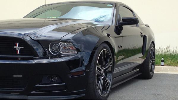

BMR with Koni orange. Great ride love my stance
Attached Thumbnails Steeda Sport vs FRPP P-springs recommendations-image-401769367.jpg
