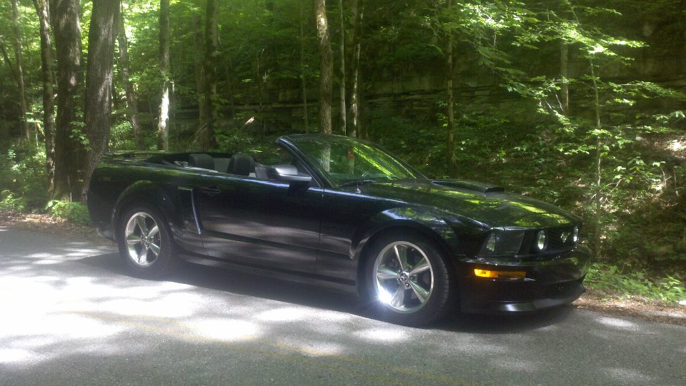

Old Jun 21, 2012 | 12:51 AM
Garry38555's Avatar
Joined: November 4, 2011
Posts: 15
this is after the coilovers were installed.
