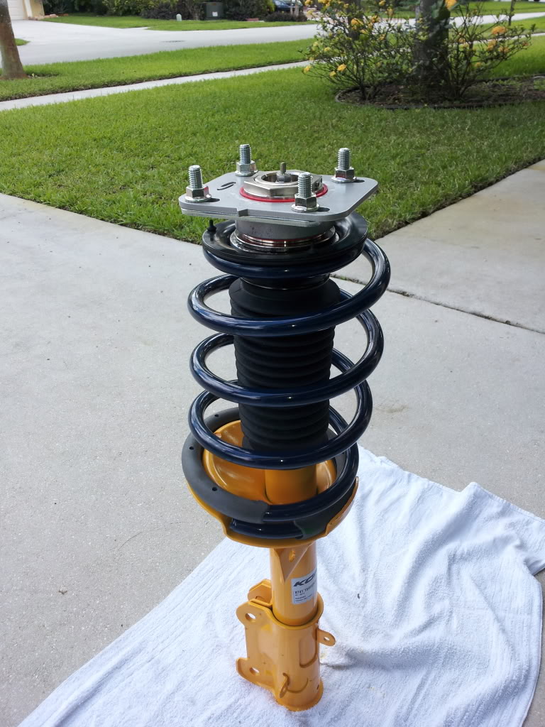

When you speak of Steeda HD Strut Mounts, are you talking about the 05-10 variety. I have the 11+ Steeda HD Strut Mounts, plus 11+ Koni Yellows and Steeda Sport Springs on my 2013 GT. In my case, I had to transfer the upper spring seat from my OE strut mounts to my Steeda HD Strut Mounts, which is no big deal. Below is one of my assembled front struts and what the stang now looks like lowered, if it helps any.
