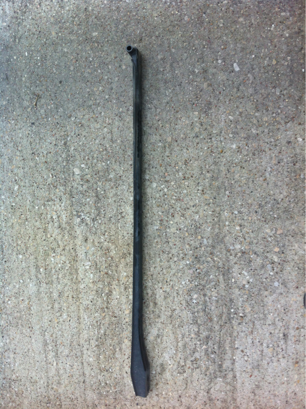

The sway bar wasn't the problems i think... I took out the frame bar right above the Panhard bar and I don't hear no clanking but I dont know how safe it is without it in since it was connected to the frame

You need that support brace in your car. It helps support the panhard bar's mounting location.
I would check your exhaust clearance, it sounds like that might be hitting the support brace.

It's hitting that support brace.. When it was in there was a gap of about 1/4 between the brace and the exhaust.. Other than removing the brace I don't see a option on fixing it.. And other options would help me out?

I know, I called Steeda and they told me it could be the bumper stop so I trimmed them, told me the axle can be hitting the exhaust so I looked and that brace was 1/4 away from frame so I took it off and I don't hear the clanking noise anymore so that has to be the issue but I think it has to be there but can't figure out what else to do without it rubbing on the frame everytime I hit a bump lol

Springs don't make noise unless they were installed without the spring isolators which gives you metal to metal contact, then it would be a creak, not a clunk.
A clunk means something is hitting, his exhaust is a good culprit. The axle could be hitting one of the tailpipes through suspension travel. If he took out the panhard bar brace like he describes and the sound went away, exhaust routes right by the panhard bar brace. Sounds like the clunk might have been his exhaust hitting the brace.
You have to understand it is hard for us to diagnose something like this due to what your describing, unless we were looking right at we could make a definate diagnosis, but based on what you are saying this is our best observation.
Let us know if this could be the issue.

Yes that is the issue TJ, the brace is hitting the exhaust when I hit an bump.. Any way I can fix this?

Well I called and talked to steeda and they said I have to loosen all the exhaust from the h pipe and work it down to I can fix the problem

Fixed! Finally lol

Yep, and I adjusted my Panhard bar also..
