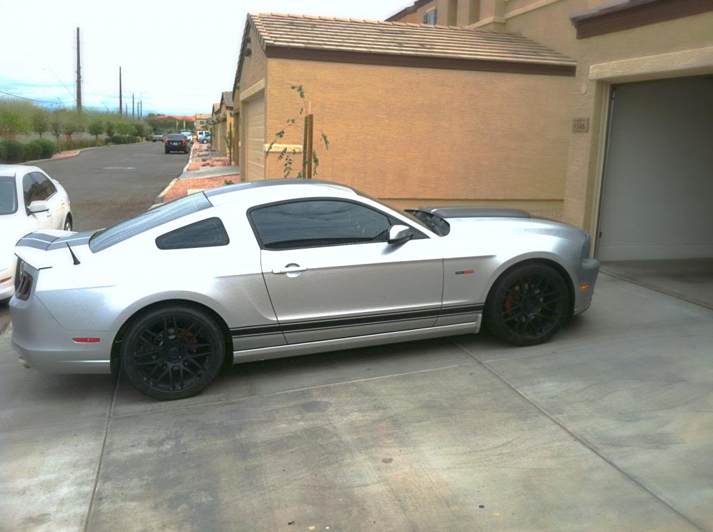

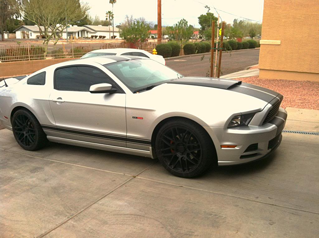

I am looking at getting a more aggressive stance for my mustang. I currently have Eibach Pro springs and the stance is definitely much better than stock. I want to get more aggressive. You guys have some pretty sick rides and I want to emulate the stance.
When I put in the Eibach's I did not have to add anything else and kept everything else stock. The alignment was good and no uneven tire wear.
Do I really need CC plates and an adjustable panhard bar for the H&R SS springs? The car is a daily driver. No tracking at all. I occasionally drive it hard, but that's on freeway on ramps and stop lights.
It may not be worth it to me to add all the other components to get it an inch lower. CC plates are over $300 and the panhard bar is $120 plus the cost of the springs. I got my Eibach's from a buddy for $80.
