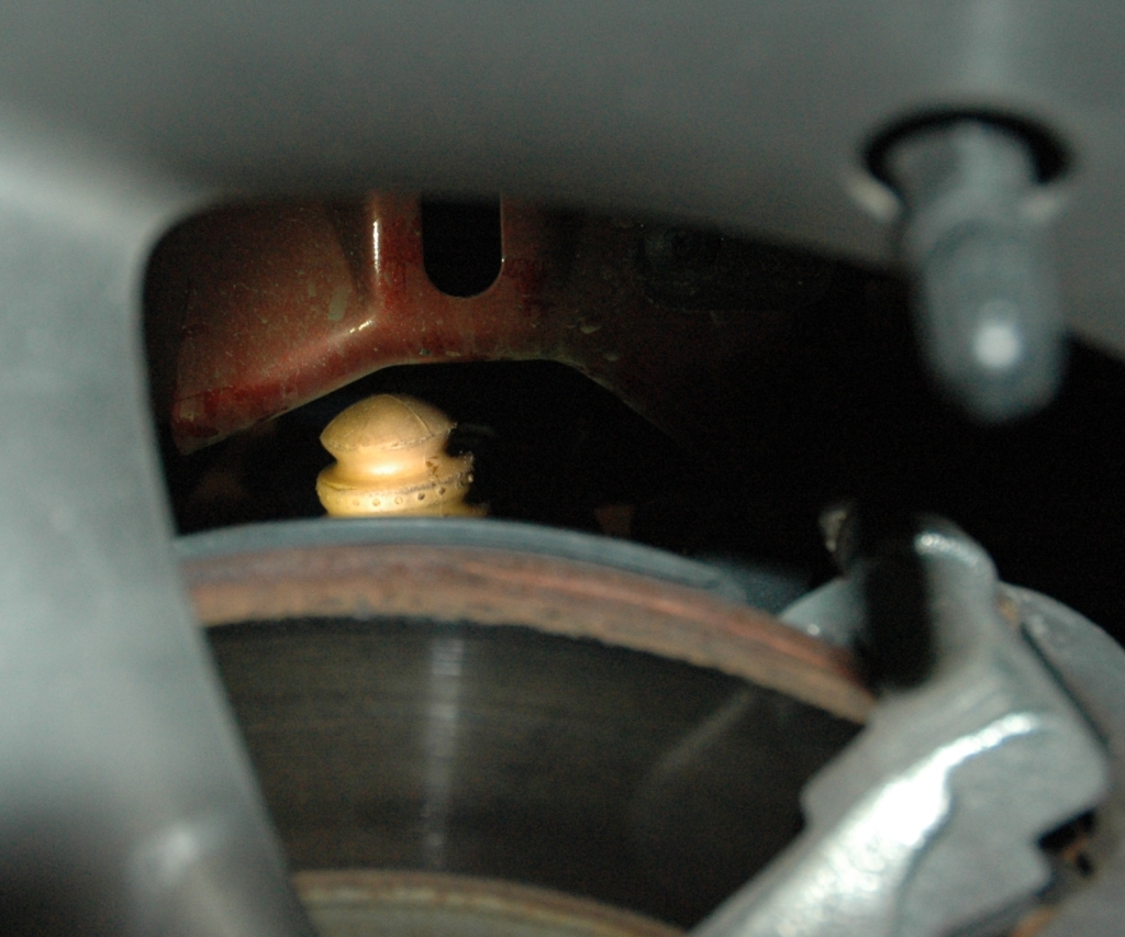

Here is the result looking through the left wheel :
There is less than 0.5" of free space (one finger)
I don't understand how the suspensions can work correctly with so little space
And it could explain the sound that seems coming from the trunk each time i drive on a road with short and harsh bumps.

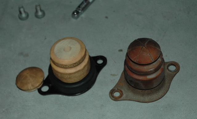

I used the same jounce stops with going 1" lower. I cut the top mushroom off and it was a much better ride. Have someone sit in your car and take a picture. That clearance will be even less.

This aferternoon, i have cut off the top of the "mushroom" and the result is much better :

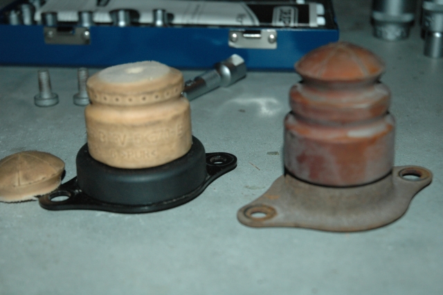

Originally Posted by JPMotorSport
But the FRPP version is clearly shorter/geared towards use with lowered setups
The FRPP version has exactly the same height as the factory one. You can see the 2 versions on this picture :
When i received my order, i was very surprised to not find a smaller version
