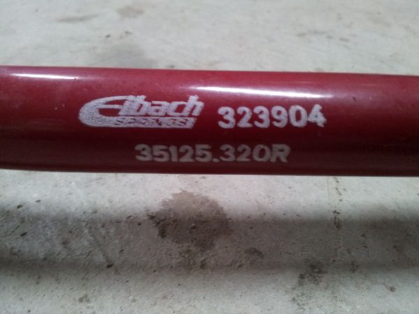

After installing my other suspension components I noticed that the car handled great! However the Oversteer that these cars have is crazy...so I finally found a used Rear sway bar on Craigslist and snatched it up. It is the non adj sway bar that comes in the F/R kit. It has the mounting bushings and end links.
I am anxious to get this installed, I will let you guys know what the outcome is!
Going to install it in the morning after I weigh it vs the stock piece and measure the thickness.

Install went great, all that was needed was a 15mm socket/wratchet.
The stock bar measuer at 3.00" in circumference...devided by Pi it is .955" in diameter (24.25mm) weight was 18lbs 2oz.
Eibach bar measured at 3.125" (3 1/8") in circumference...devided by pi it is .995" in diameter (25.27mm) weight was 18lbs 7oz.
Short driving impression was good... felt smooth and flat.
