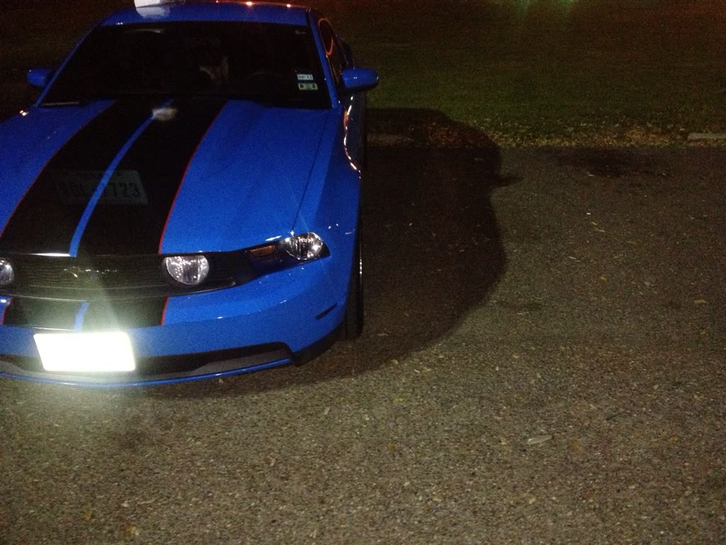

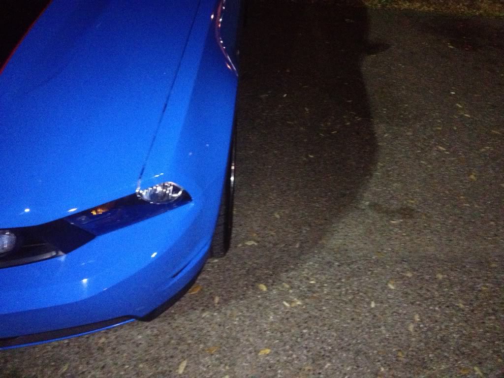

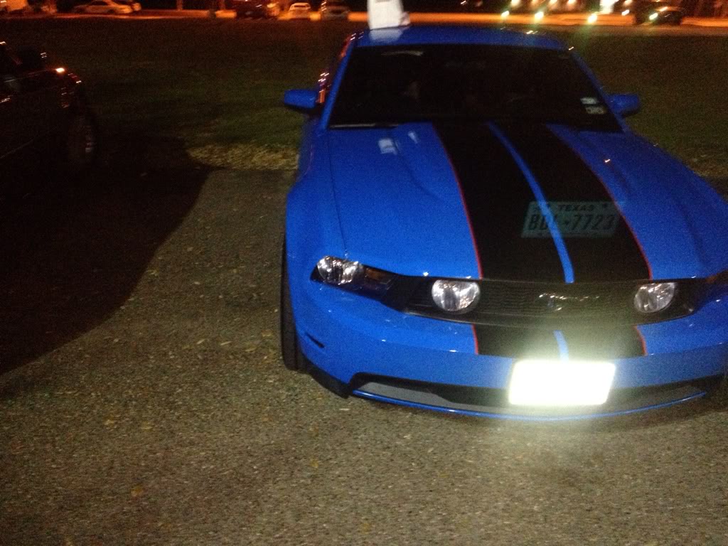

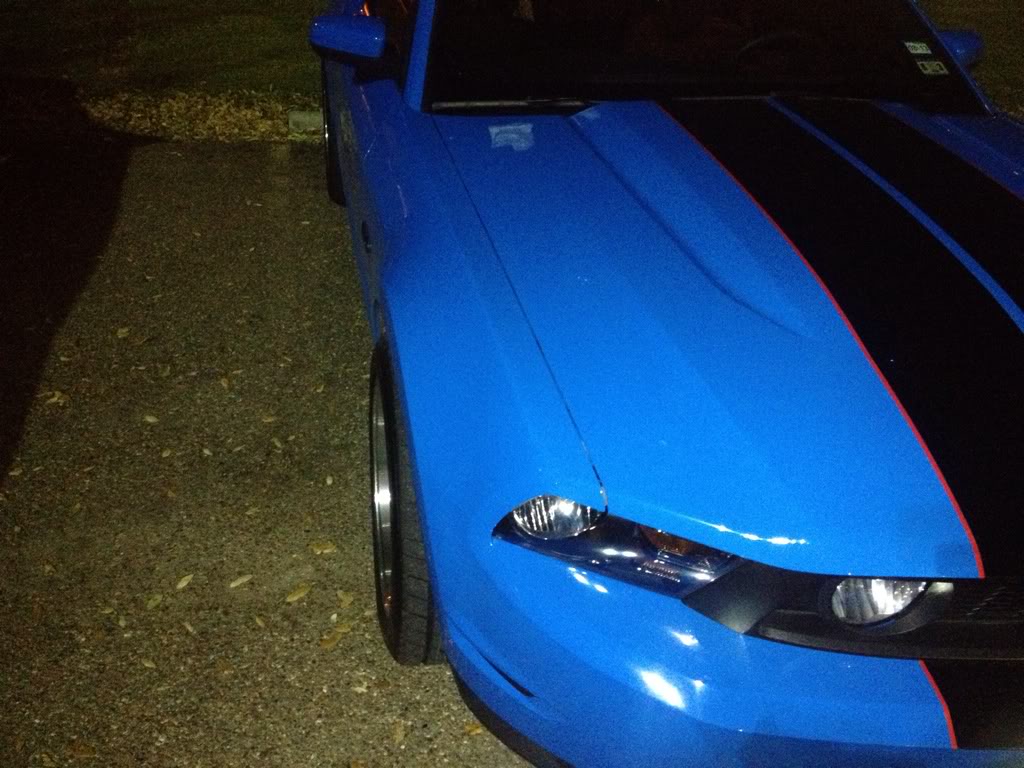

Dude mine looks way off as well!! I know this is an old thread but Idk what to do, I haven't even done the rear and I haven't had a chance to do the front. My wheels came in and the rears look fine on SR springs and stock shocks, the front is stock setting besides the 18x9 255/45
Driver side pushed in

Passgr side pushed out

Did u fix yours ? An how please

Originally Posted by Bert_grblue
Dude mine looks way off as well!! I know this is an old thread but Idk what to do, I haven't even touched the front and I haven't had a chance to do the front. My wheels came in and the rears look fine on SR springs and stock shocks, the front is stock setting besides the 18x9 255/45
[/QUOTE]
Yes I fixed mine, I loosened the k member and using a pry bar, I shifted it back over to where it needed to be.
I hung plumb bobs off each fender to measure off of to the rotors.
Mine was off in the same direction as yours. Have you had your k member off before?
