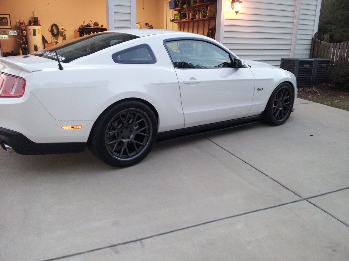

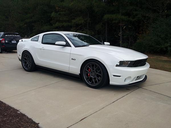

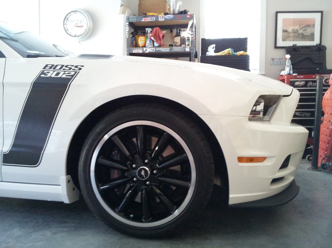

Here are some pics of an 11 and 13 installed with Hotchkis springs. The 55d rears from what I understand are just stiffer springs without offering much of a performance gain.

Really like the Hotchkis setup, and appreciate the info from Jason at Hyperautomotive.

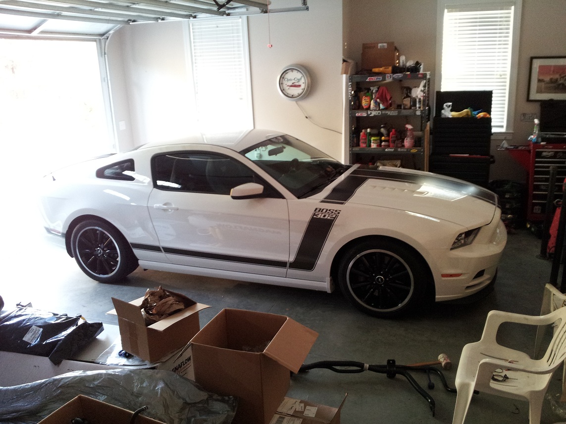

Here is a picture of my 2013 Boss 302 with the Hotchkis springs.
The ride quality is great and soft like stock.
