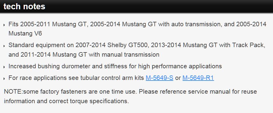

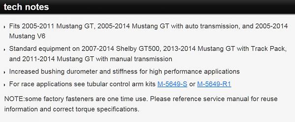

Did you see the tech notes in the FRPP LCA link?
http://www.fordracingparts.com/parts/part_details.asp?PartKeyField=9630
Your ‘14 GT track pack should already have them.

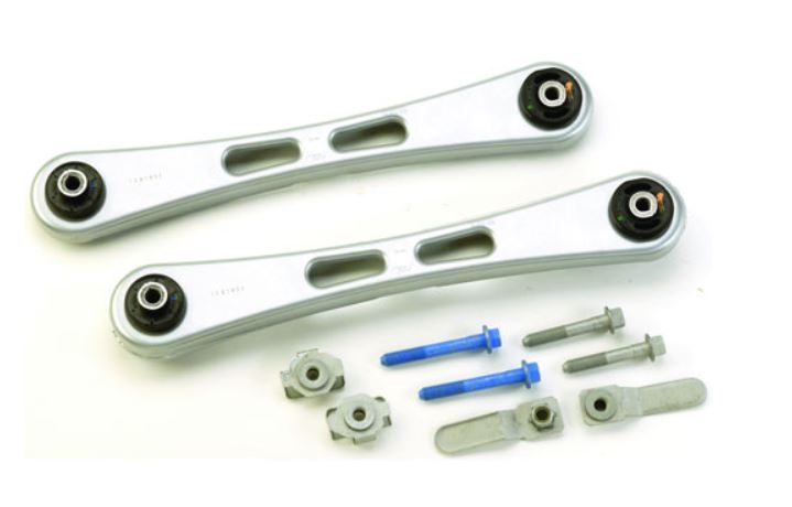

Links not working for you? Hmmm ... try a search for FRPP LCA part: M-5538-A, they should already be on your ‘14 track pack. These are the same LCA I installed on my ‘14 base model as an upgrade. (info below) Other FRPP LCA’s are: M-5650-A and M-5649-S
