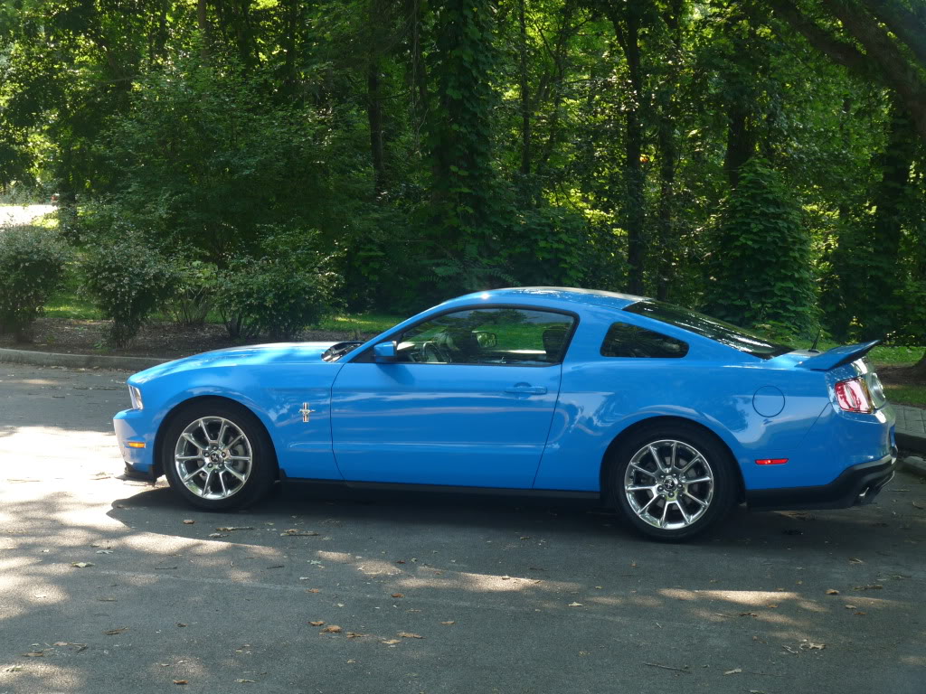

I was running Vogtland .8/1.2 on my 2010, I was using Camber bolts in the front and had to do nothing in the rear, it was about and eighth off was all. Pinion angle was OK and the Stance was perfect for me. Thinking about doing the same set up on the 2013 to get a little better in the handling end but more for the rear setting up so high.
My old 2010

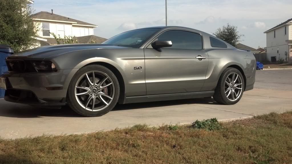

I installed the Eibach Pro-Kit for the 2011+ (not the 2010, there are different part numbers, and have different drops). I did not use any other supporting mods except an adjustable panhard bar. After the install I took it to sears for an alignment, and everything but the toe on the passenger side was within factory specs.
Before
After
