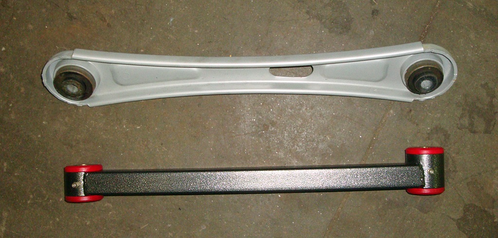

Which one looks beefier? LOL

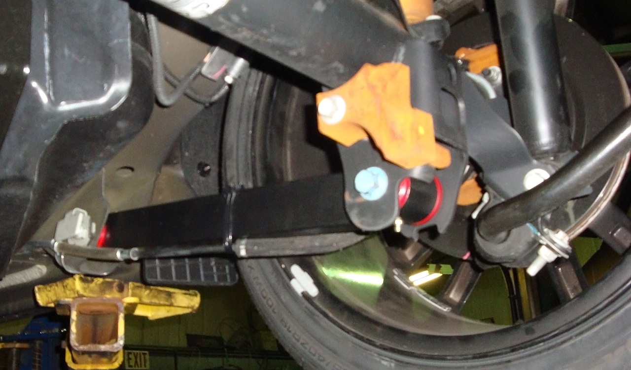

Right rear BMR installed:

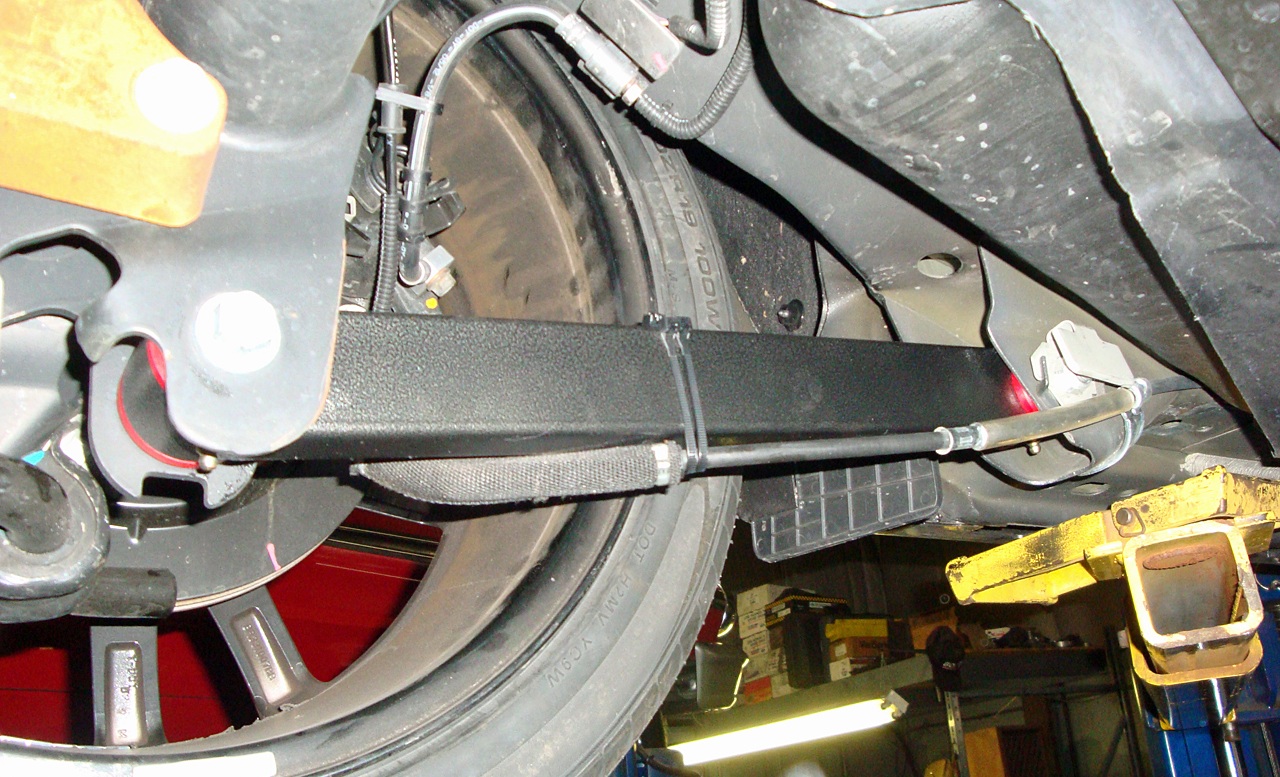

Left rear BMR installed:

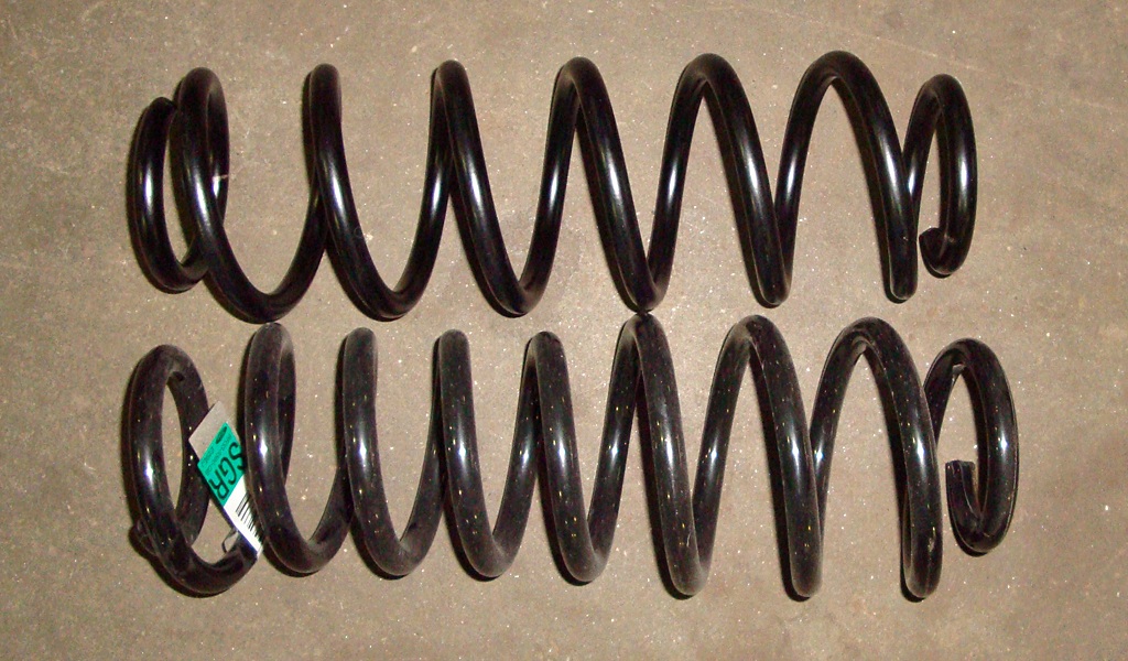

New spring on top, original spring on bottom:

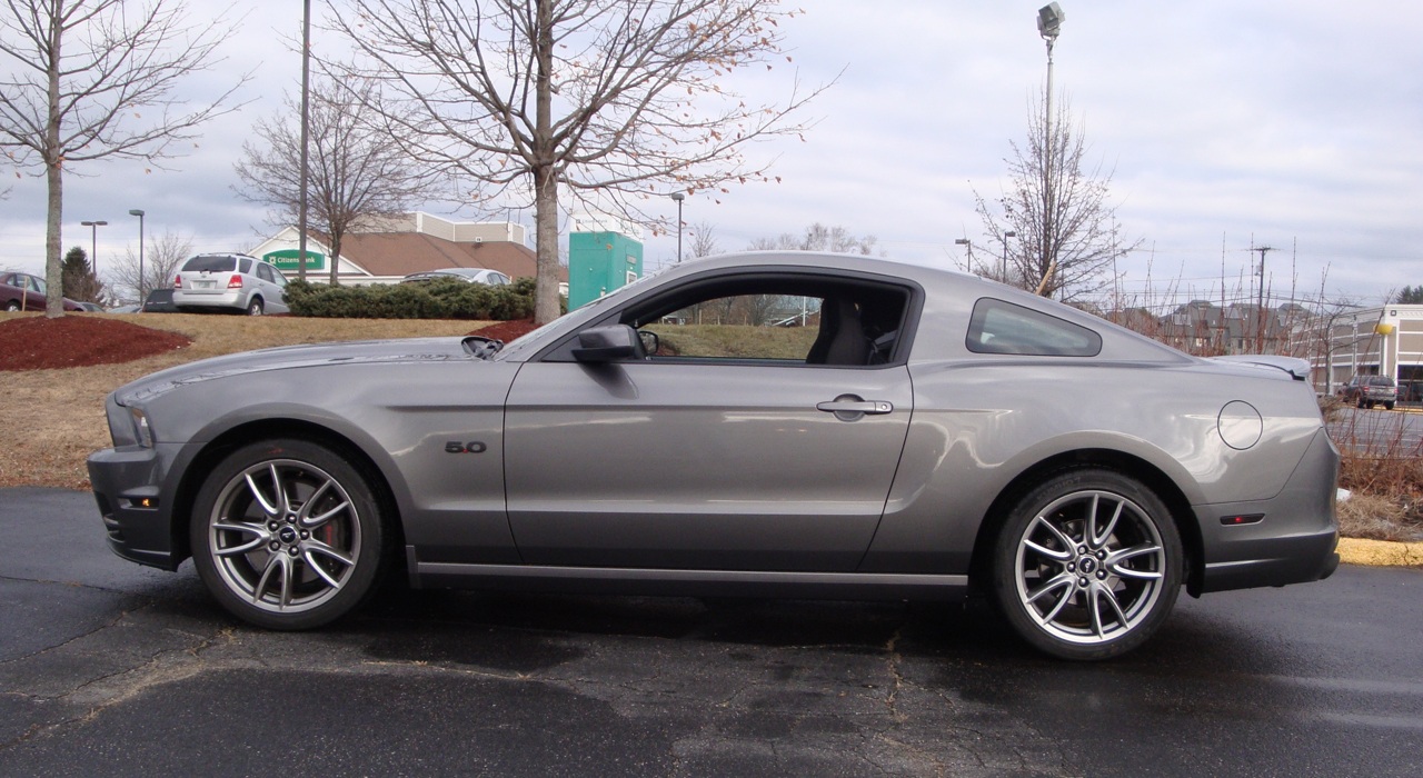

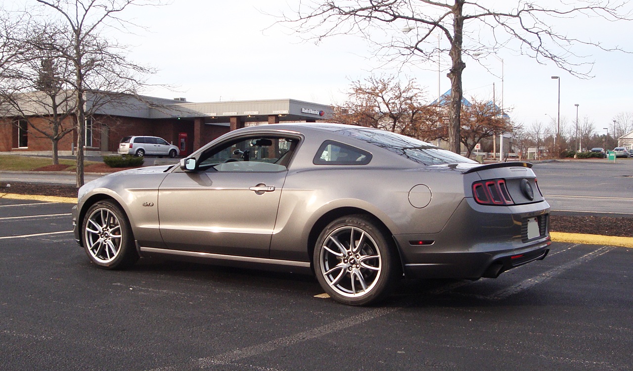

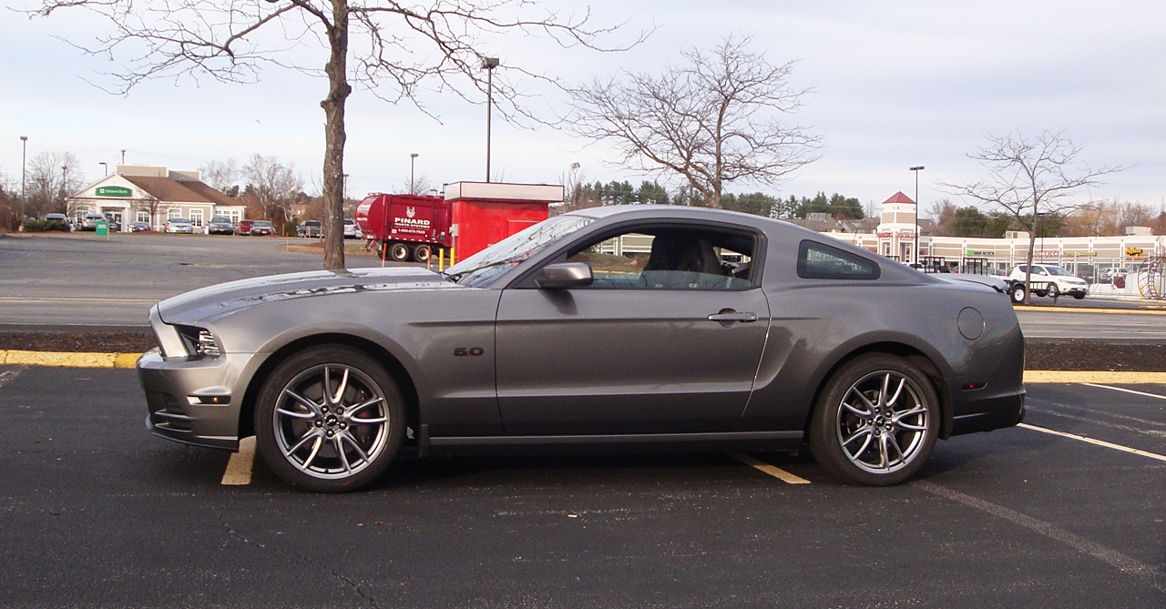

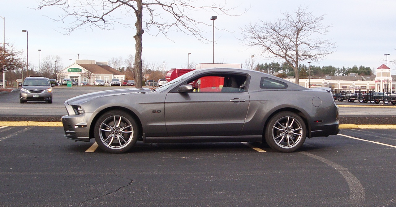

New spring installed:

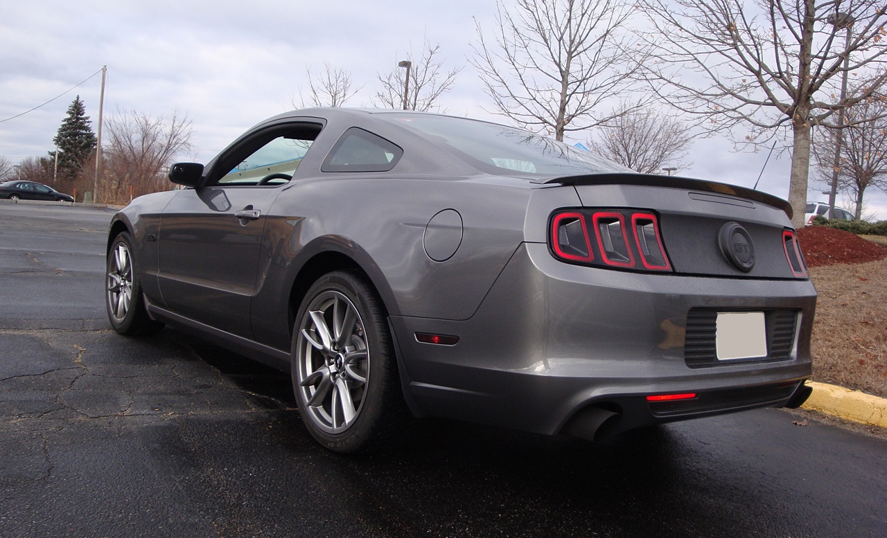

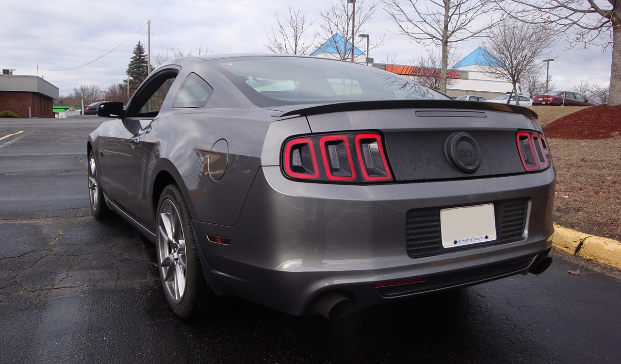

New ride height:
Only put about 50-75 miles on the new set-up so far, maybe they'll settle a little bit more ... so far I like what I see though.

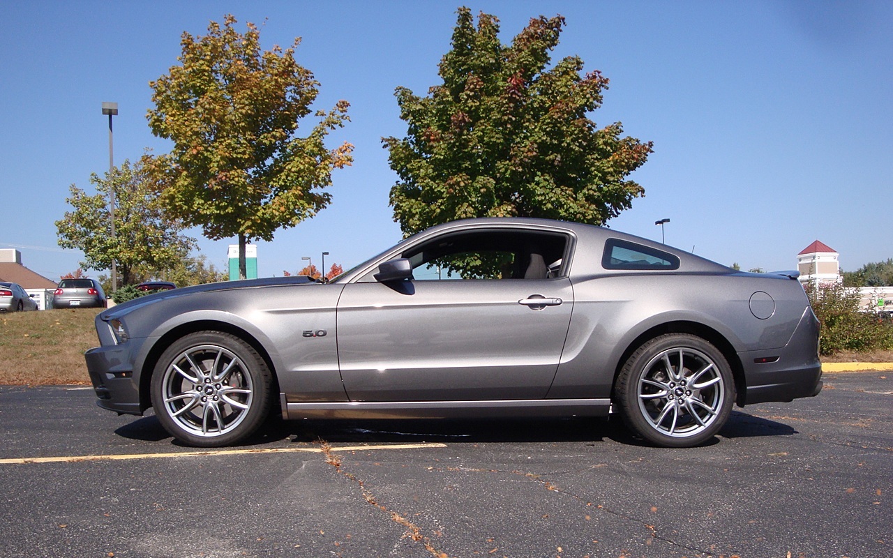

Edit: The "before" :
Edit #2, after about 300 miles on the new springs:

After roughly 300 miles on the new set-up I can say I'm about 97% happy with it.
Axle/wheel hop on a clutch-dump launch off the line is gone on dry pavement, and about 95% gone if moving in 2nd gear about 20-25mph and revving/dumping the clutch - it spins, goes sideways depending on how much throttle I give it, or if I lay into it, but hops a little bit.
In the wet I still get a decent amount of wheel hop and that tells me I'm not not modding the rear suspension.
Relo brackets and maybe an upper control arm replacement will be done. Not sure when cuz for now I'm pretty darn happy with the car, but they will happen eventually.

Thanks and no, it hasn't, ... I'll try to take some new pics again soon, maybe they've settled a little more.
I'll be driving the car tomorrow so hopefully I'll remember to pull over somewhere and snap a couple new pics.

I just added 3 new pics to the first post, taken earlier today, so after about 300 miles on the new set-up.

I like the set-up quite a bit. I didn't want to lower the whole car, I only wanted to get rid of the huge height in the rear, and these springs have done that for me.

Had some creaking from the LCA bushings ... bought a tube of synthetic lube and a lube gun with a flexible extension and pumped until grease came out of the sides of the bushings ... noise gone
