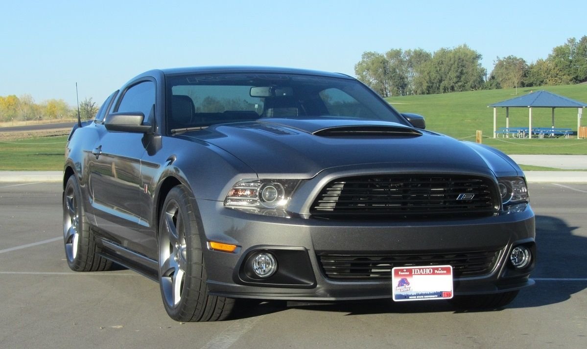

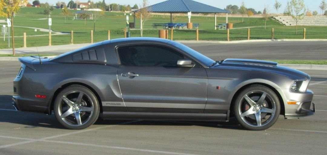

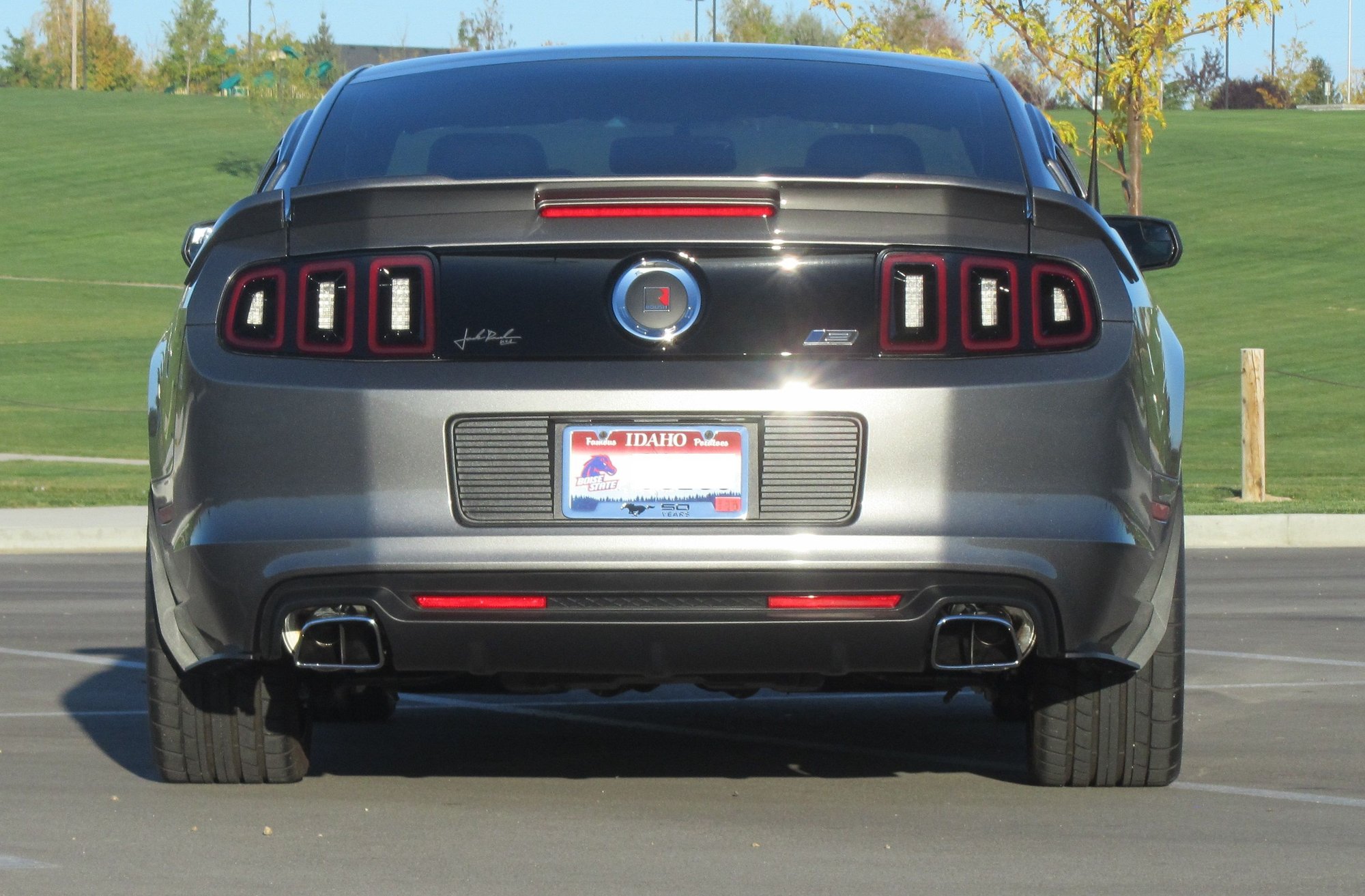

On my 2014 "GT" Roush Stage 2 I run the 20" Roush rims (Impossible to find now but... ) Size wise they are a 9.5" width. I run 275/35R20 on all four. Love to drive it and love the looks. Having all four the same size simplifies rotation as well. Just my 2 cents... Hope this will give you an idea of that size on our cars... FYI Mine is also lowered some 1 and 1.5" to level the ride.
