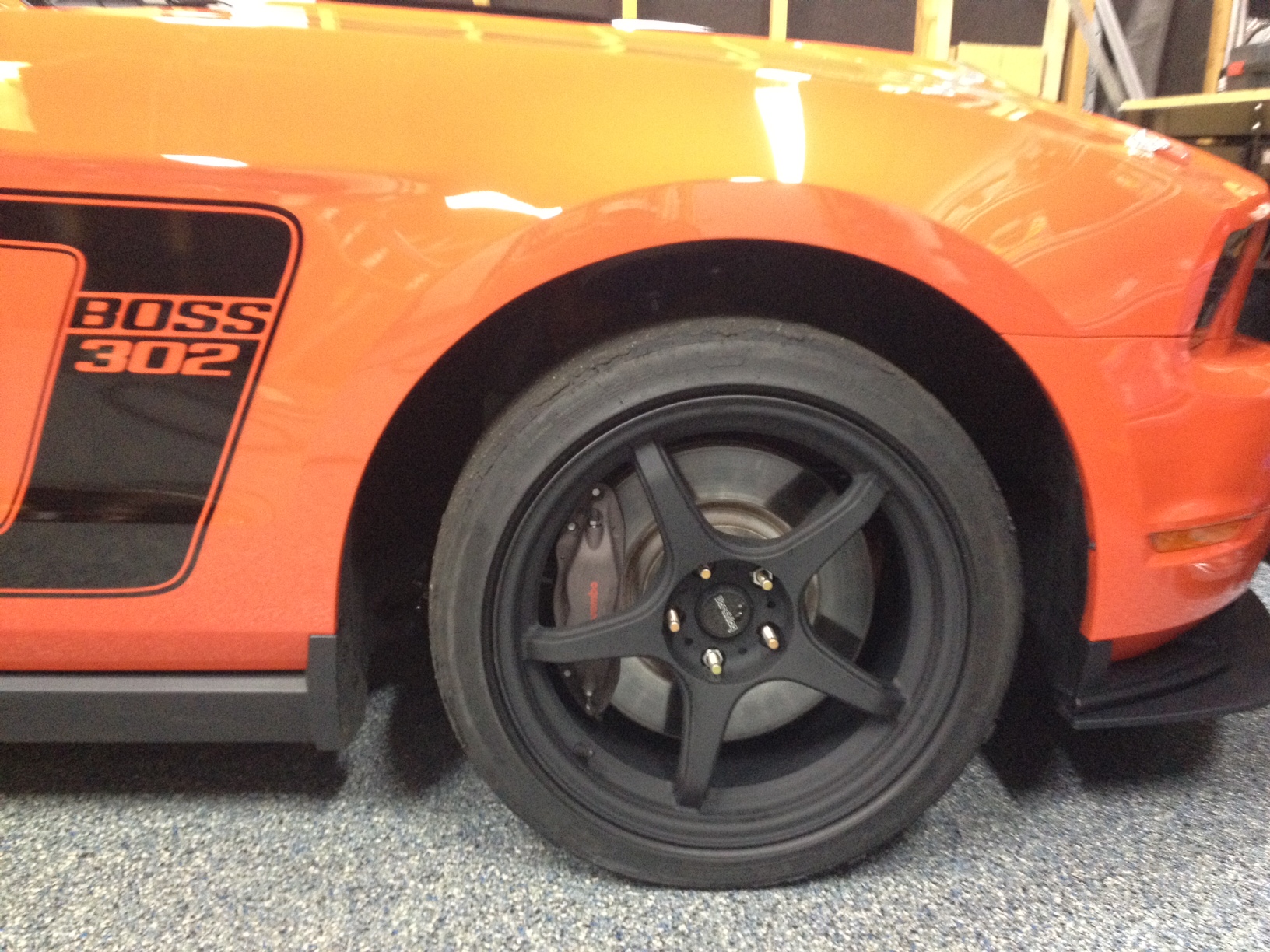

18x10 D-Force Wheels (from Vorshlag) with 275x35 Continental tires (TINY!!!!).
Attached Thumbnails Track Wheels/Tires-dforce1.jpg   Track Wheels/Tires-dforce2.jpg   Track Wheels/Tires-dforce3.jpg

Throw some 305/650s on there next time

John, only you could make 18x10s look small.

Do those wheels use a centering ring or are they lug-centric?

They are HUB-centric! No centering ring necessary.
