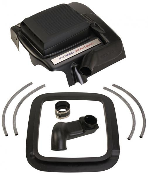

That makes sense with respect to the 03's. But the current cars now get their air from in front of the rad, which should also be experiencing a fairly decent ram effect as well, if not the full effect. It's possible that the pressure losses between the shaker inlet and the stock air filter could be close to comparable to the losses seen at the stock air inlet. I would expect the overall difference could be less pronounced that in the past.
Also, the 2003 shaker ducting looks to be much more free flowing than the 2011 version.
Of course, the final proof will be found at the track.
Attached Thumbnails For those hoping for a Shaker hood scoop for the 2013-shaker.jpg

Exactly (at least on the '03-'04 Mach 1 set-up)...that shaker was tested, as much as they could do it, to prove there was a pressurizing effect. This is what was said to contribute to the shaker effectiveness on that model.

It has been said that a scoop in the middle of the hood offers little performance gain since this is a relatively low pressure zone. The only way that makes sense is if the scoop is tall enough to reach the high pressure zone above the hood such as on a Pro Stock drag car. Not very practical on a street car though. Having the air inlet in the grille should provide more of a ram effect since that is a much higher pressure zone but it also requires a less aerodynamic frontal area. Using a cowl induction type hood that draws air from the base of the windshield is probably the best compromise since it takes advantage of the high pressure zone at the base of the windshield but does not induce additional drag. A good example of this is a NASCAR stock car. Rather than take air from the grille which would require a bigger open area on the front of the car (more drag) or place a front facing scoop on the hood they pull air for the carb from the base of the windshield. Why do you think the air intake for your car's HVAC system is at the base of the windshield? No offense, but placing a scoop in the middle of the hood is more about appearance than performance. There is absolutely nothing wrong with that but those two goals are sometimes conflicting.
