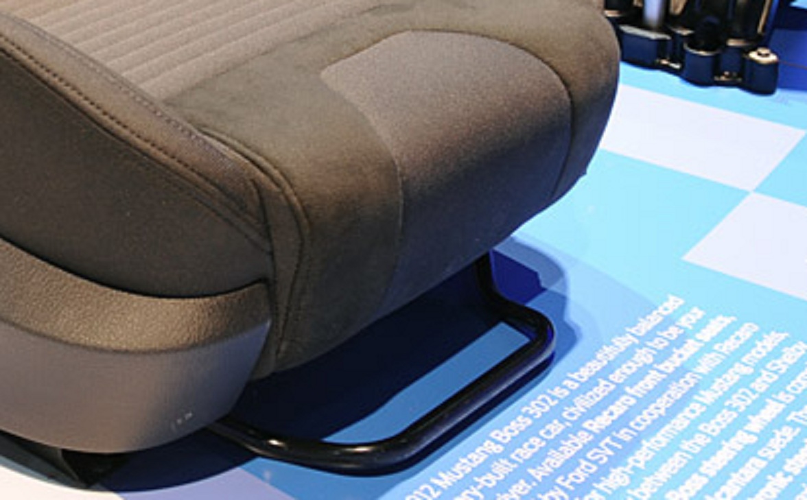

Do the recaros at least have the leg extender, under the knee ?
I run my anti submarine belt thru that on the recaro seats in my 2000 R, and attached to a welded tab on the floor with no problem.
Old Jan 12, 2011 | 06:33 PM
Tony Alonso's Avatar
Joined: February 8, 2004
Posts: 3,399
From: Cincinnati, OH
If you look at the picture in this post, you will see it does not have leg extenders.
At first I thought that but you can see by the seat pics from the L.A. show they do not. The first pics I saw were from the back of the seat looking forward and it seemed that it had it.
I had a 1987 Thunderbird Turbo Coupe, the seats had them and I loved it. That was a great car but had many small problems. Still would love to restore one, drove it from VA to FL without stopping for gas!
