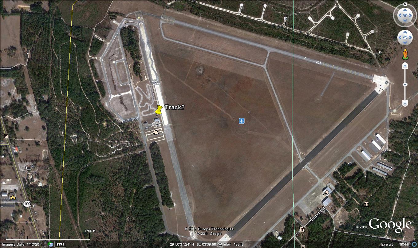

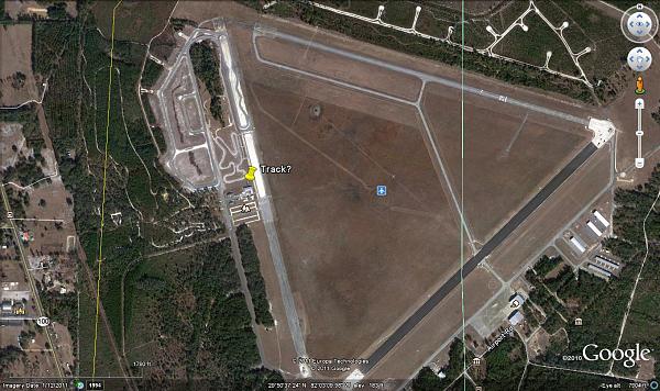

John if you are familiar with the tracks down here, have you ever heard of this place. I had not until yesterday. Any info to pass on since it is a (sort of) haul from here, maybe 3+ hours. It is in a town I had never heard of - Starke at an airport I never heard of - Keystone Airpark.
http://gorally.com/erssite/html/cartrackdays.html

BMWCCA has an event coming up next month there, DE style for $189. Not too bad.

That is how I found out about it, got an email from them. They must have my info from Trackweekend. I am going to find out more but do you have any first hand knowledge? Looks like they have open track days also, just bring you car and helmet
It's shorter and a lot of turns so that could be fun, unfortunately also looks very flat. I have been wanting to test a shorter track with more turns.
