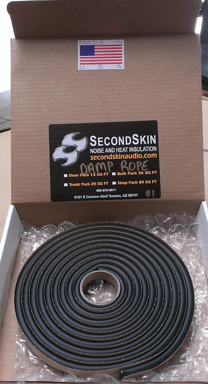

I wanted to change up the front end a little bit and I remembered seeing a set of headlights that AM and LMR had sold so I went looking for them. I found them on LMR, or so I thought. They were supposed to look something like this according to their webpage:
When I received them they looked just a wee bit different:
Not only were the lenses black black, they didn't properly fit! Notice the large gap between the headlight and the grill -_-
Anyway, I figured I would pull the black lens off and swap it with my factory clear lens since the internals are all black with clear turn signal lenses. So I pulled out the factory headlights and turned the oven on and set the temperature to 235 degrees. While I was waiting for the oven to preheat I removed the rubber gasket for the headlights.
Once I removed those, I ended up putting the headlight in the over for 10 minutes. I was wearing my work gloves but you could still feel the heat as you were prying off the lens. I ended up putting it in for 2 cycles at 10 minutes each and finally the lens popped off to reveal the lights.
In order to get all of the rubber out, I threw it back in the oven for another 10 minutes and it all easily came out without issue. I grabbed the rubber butyl I bought and began putting it in the recess where I removed the old rubber. Granted this stuff is a little thick at 3/8" but if you stretched it a little and pinched the bottom it went in without issues not to mention I have so much left over. This is what I used:
Made in America
From this point I grabbed my factory headlight and turned the oven up to 275 and put that one in there. After 3 rounds of 15 minute intervals I was able to get the lens off and put it on the new headlight housing. After squeezing it in together by hand I put it in the oven at 275 for 7 minutes and took it out again and clamped it down.
As you can see I only had one pair of vice grips so I had to improvise a little.
Anyway, as I let that one sit for 45 minutes I went to work on the second factory light. Remember when I said I can break anything
I had the entire lens off except for that one corner .... ****
I bought a factory lens off of ebay with a tab missing for $55 shipped and went along my way. I got the second headlight a few days later and without much, if any difficulty it popped out and went back on easy peasy.
It looks like with the factory lenses in there the gap is smaller so I think I am ok with it now and it isn't going to drive me crazy. Maybe it will but who knows. After almost 2 months of rain and most recently snow, the headlights have held up and I don't see any fogging inside of the housings so I think I am pretty good on this setup. I like them, they add a small distinct touch and a bit of the blackout look without going overboard IMO. Now I just need to get clear turn signal bulbs.
Parts Used
  • 2010-12 Ford Mustang SVE Euro Style Headlights Black - S197 - SDT-MST10SM
  • Damplifier Butyl Rope (3/8" X 15' Each) - ROPE
