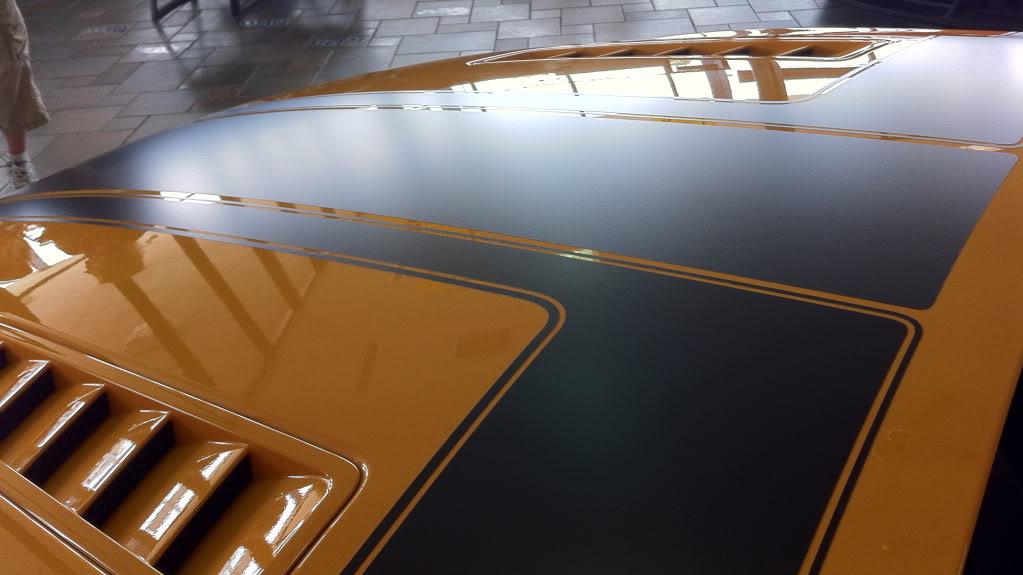

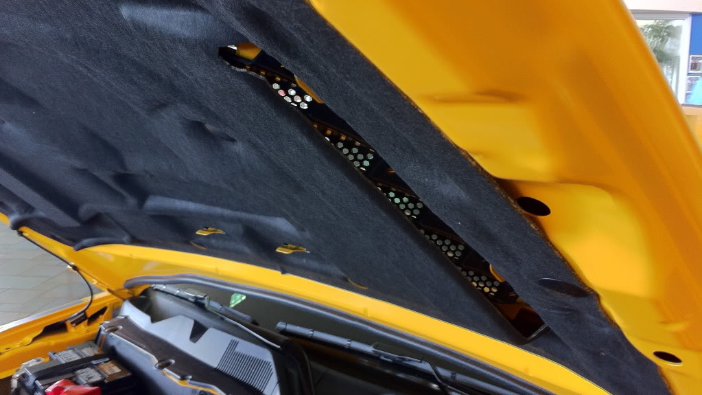

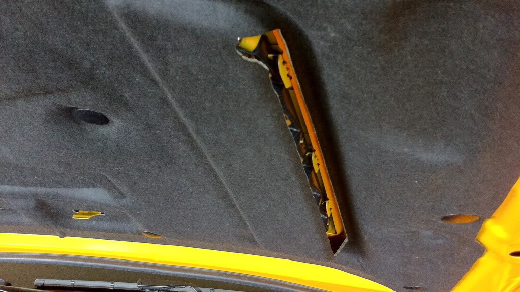

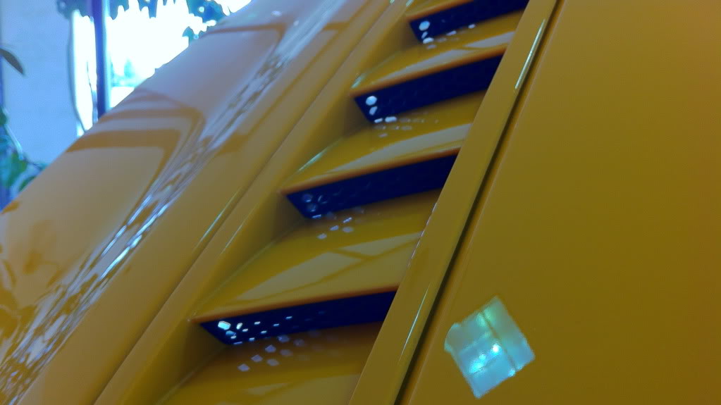

While adding vents will help dissipate the heat under the hood I don't think they will help with the overheating issue. I also looked at adding vents to my hood but I don't think there's an easy way to add them that still looks OEM. Best bet is to save up for an aftermarket hood and there are a couple of less expensive options other than the 302S hood. Here are photos I took of the new vents.

Are the openings on the 2013 hood only about 1/4 of what apears on the top of the hood? The openings look to be off to the side only??
Old May 28, 2012 | 07:26 PM
5 DOT 0's Avatar
Joined: December 18, 2010
Posts: 3,708
From: NorCal
The vents are fully open but the material under the hood covers a lot of it. You can easily cut it out if you're having overheating problems but I don't think it's going to help much.
