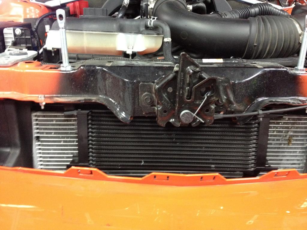

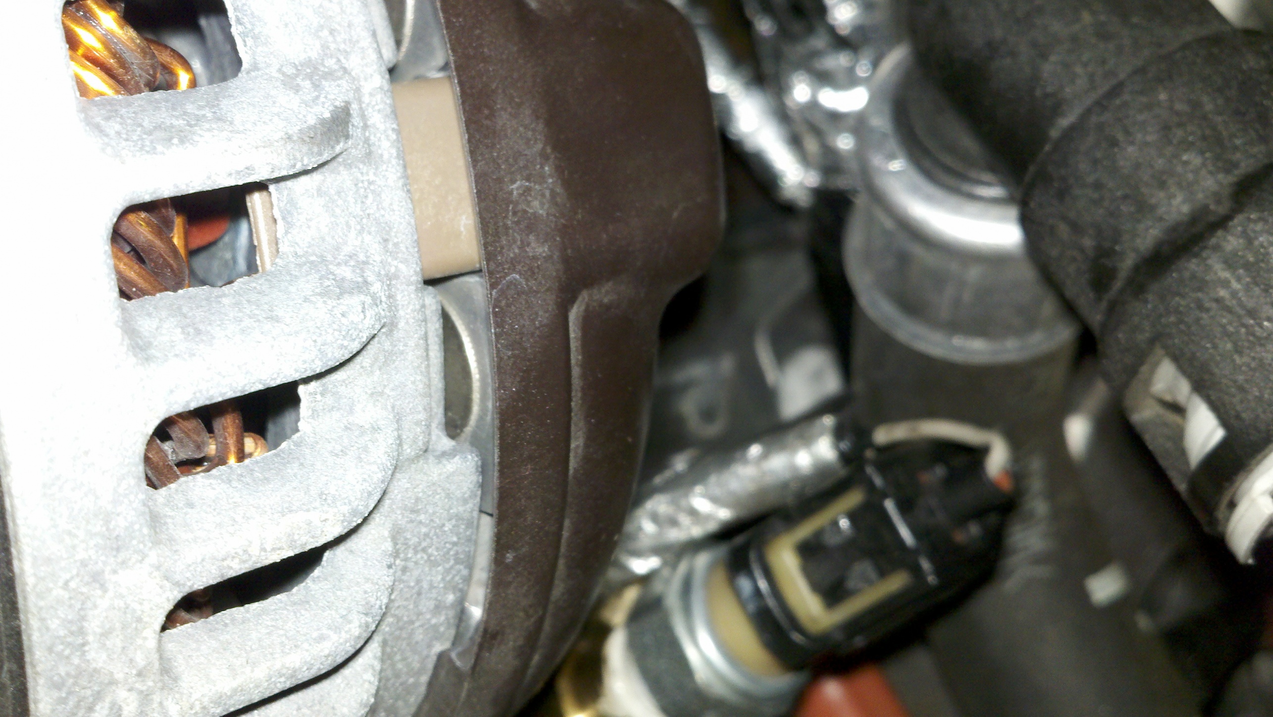

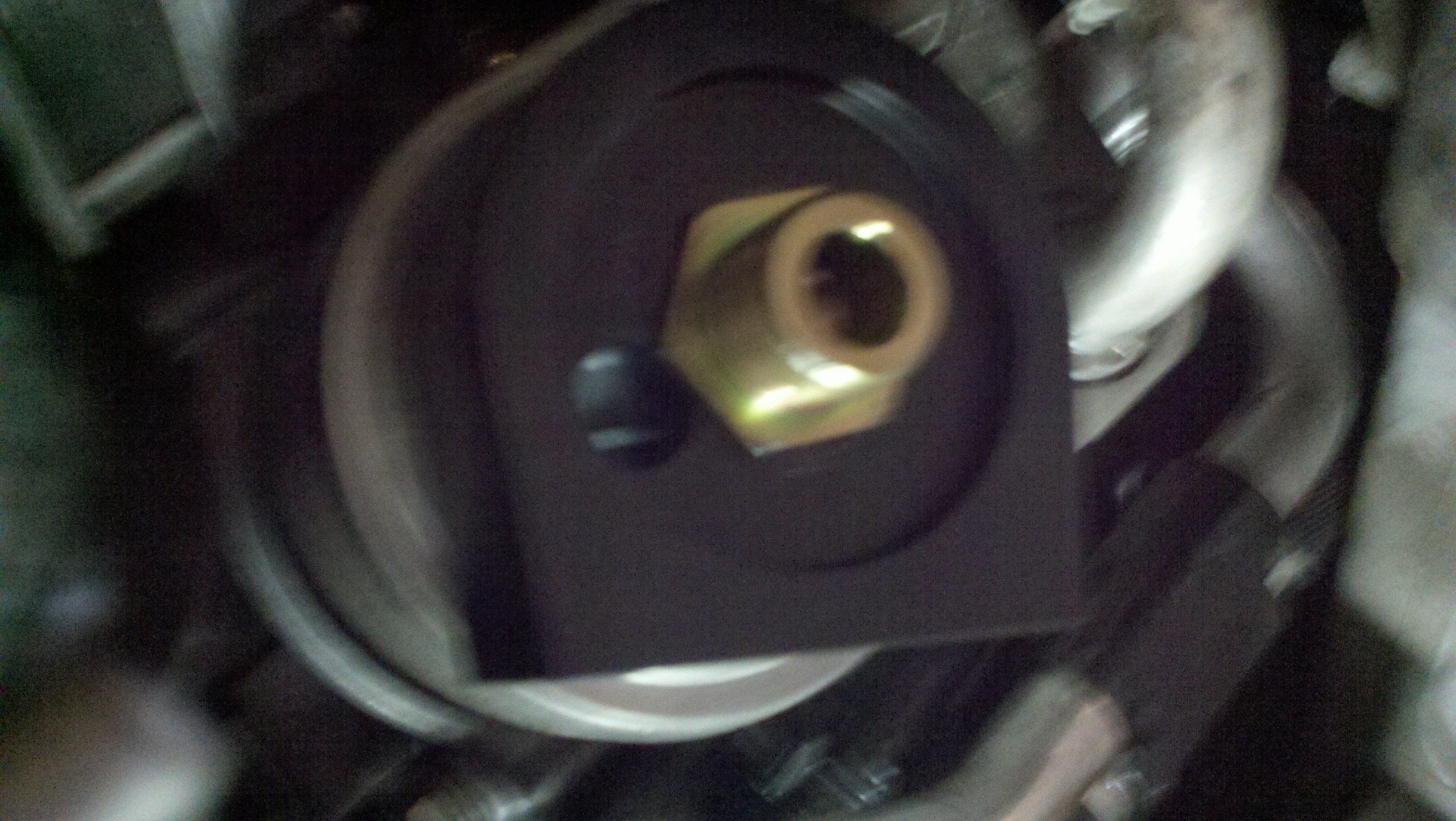

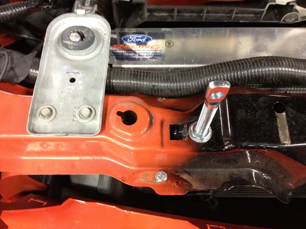

Install pics. The temp sender is on the backside of the T so you can't see it in the pic. What you're seeing is the factory pressure sensor on the other end of the T.

Did they have to remove the bumper cover for the install?
Old Feb 23, 2012 | 03:52 PM
  #66
cloud9's Avatar
Joined: November 20, 2010
Posts: 2,382
From: Sioux Falls, SD
*Sorry for the incorrect initial post* Nope. Just pulled the grille.
Old Feb 23, 2012 | 04:12 PM
  #67
JScheier's Avatar
Joined: July 4, 2011
Posts: 262
From: Parker, Colorado
Is that going to interfere with installing the splitter bracket? If I gotta remove the cover, I really only want to do it once. I'm lazy like that
Old Feb 23, 2012 | 04:16 PM
  #68
cloud9's Avatar
Posts: 2,382
Splitter wasn't available until 2/28 so not sure if it'll stay there that long. That said, if you're going to do both, might as well do them at the same time and give yourself more room to work

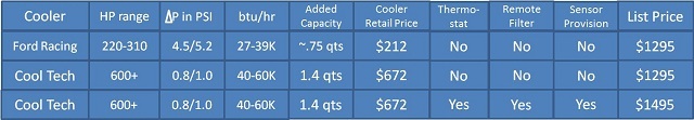

Kendal ,How is your non-thermo. unit progressing? and will it mount like the Ford unit. Thanks
We have both a theromstatically controlled cooler (with remote filter) and a non-thermostat version available on the website. Here's a comparison of the different coolers. (All data from SETRAB technical specifications.)

Good info. Lest anyone think that a 1-series is not as good as a 9-series - you just have to look at flow drop differences and price differences (all Setrab data) to know that the 1-series is a much better, albeit more expensive, cooler.
