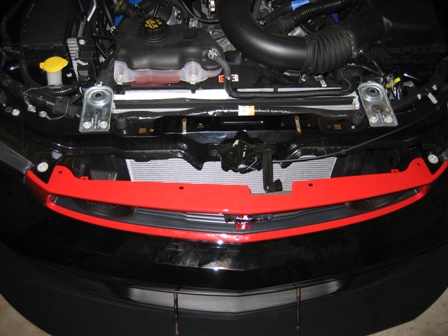

Just waiting on my Aeroforce oil temp sensor then it's going in and we're ready for the tracks to open (hopefully) in March!
Attached Thumbnails FRPP Boss 302 Air-to-Oil Cooler is now available-2012-02-15_11-38-42_564.jpg

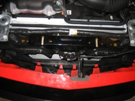

INSTALLATION QUESTION - Does the FRPP cooler install in front of the A/C condenser - or behind it (between the A/C condenser and the radiator)? The in-between location looks crowded.
If it is mounted in front of the condenser, what does the support bracket bolt up to? The radiator support on one side and the other side??? Maybe the grille?
It installs in front of the AC condenser and hangs from four bolts through the radiator support. Here's a picture of it in the 302S:
The bracket looks like it is centered on the radiator support - with the four bolts attached to the small flanges on either side of the radiator support.
Isn't the A/C condenser installed under the center of the radiator support?
From the pictures it would seem that the A/C condenser has to be removed to install the FRPP oil cooler kit with the supplied bracket.
The 302S doesn't have A/C so this in not an issue. In the picture below I think the silver part behind the oil cooler is the radiator
Condenser doesn't have to come out. I'll take some pics when it's done. I'm waiting for an oil temp sensor from Aeroforce before installing.
OK, I think I see it now. A drawing from the shop manual shows the condenser attaching to the front of the radiator. That location moves the condenser back from the center of the radiator support to make room for the oil cooler & bracket.
