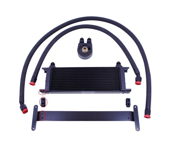

Originally Posted by 2012-LS134
Ummmmmm...aparently you didn't look at the picture. The bracket bolts to the back of the cooler -and- the cooler/bracket bolts to the front of the A/C condenser or radiator.
Air flow is restricted with either the bracket in front of the cooler -or- in back. Air has to pass into the cooler as well as out of it in order to take away heat.
Granted, some air will flow around the bracket, depending on how tight the bracket bolts up. But why restrict airflow when the goal is airflow through the cooler.
How do you know where it mounts or how it is mounted? Do you have instructions to it? I think the Ford Racing team just might knows what it is doing.... But you discovered a major design flaw from a picture of parts! They need to hire you as a consultant
Here I go defending Ford Racing's design.....
Their bracket does NOT block any air flow. The bracket shown mounts up against the main radiator support structure and the cooler "hangs" down from it. As such, the bracket will not impede air flow. The Cool Tech cooler mounts in a very similar way.

Thanks Kendall. That is how I thought it was mounted. But I wasn't sure enough to post because really what can you tell from a picture of a bunch of parts....???? Unless of course if you're Al...

Adam - My mistake.
Kendall - thanks for clarifying

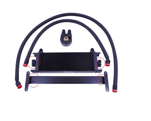

What I thought what was attachment ears on the side of the cooler in the FRPP photo are probably mounting isolators.
Perhaps if the picture looked like this I wouldn't have stepped in it.
Back to my hole...
Yes, you are right. These are merely isolators. The bracket is "on edge" nestled up to the horizontal radiator support and the cooler hangs on it via the isolators. It is actually quite sturdy and when the lines are connected they actually make it that much more rigid.
Attachment 100062
Attachment 100063
Back to my hole...
I saw the exact same thing at first and like you it didn't make any sense. That is when I noticed the mounting holes on the top of the cooler and thought it must mount to to the radiator support bracket and hang down.
